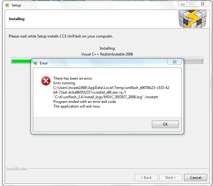

hi..!
I recently download the offline version of uniflash_3.4.0.00003_ from TI
well, I wasn't able to install the setup. it gave me the following error.
Is there any way I could carry out the installation successfully ?
Thanks and Regards,
-Maisie
  • Hi Maisie,
    Can you attach the error log file mentioned in the above directory?
    Gautam
  • Hi Maisie,
    You can download and install vc redistributable (x86) 2008 first, or you could try installing the newly released Uniflash 3.4.1.
    Danish

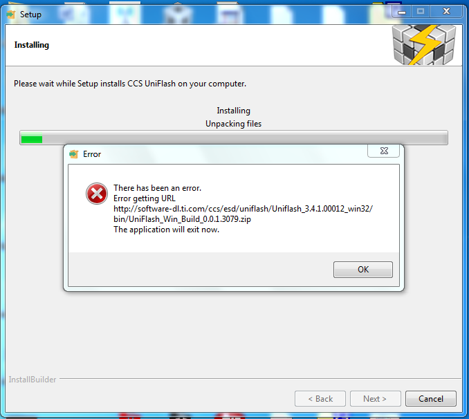

    well i have tried installing the newly released Uniflash 3.4.1.
    it gave an error as shown :
    I have also attached the error log file

  • Could you try it again? It could have been a hiccup in the network.  Or you could download the offline package.
    Danish
    I tried installing the offline package too . Gives me the same error as shown previously.
    Thanks and Regards,
    Maisie
  • Hi Maisie,
    The offline package doesn't look to download anything from the server. Did you unzip the zip file, retaining the folder structure?
    Danish
  • Hi Danish,
    I hadn't realized that before. So I unzipped the the zip file ... and it did get installed !
    Thank you very much !!
    Maisie
