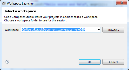

Is there a way to have CCS4 display the current workspace? I have generated several workspaces for various version tests but cannot see a way to have CCS4 display which workspace is currently active. Even if you File->switch workspce, the default workspace that comes up in the search window is not the currently active workspace.
Quirky
  • Mike,
    A quick tip that I use is to go to menu File --> Switch workspace. The name highlighted is the workspace currently being used.
    Although CCS does not display its name 100% of the time, it is at least useful to not be lost in the sea of workspaces (yes, I also use several of them).
    Hope this helps,
    Rafael

  • Mike,
    Not sure about feature request forum, but there's another ad-hoc method; which works all the time for me.
    While Eclipse is running, try to  bring up another instance of Eclipse. You'll get a message indicating that "Workspace in use or cannot be created, choose a different one.".
    Then click "OK"  and you get another dialog box with current workspace's location.
    (of course, you can try renaming that folder to confirm if it's indeed the current workspace or not!)
    I agree that there should be a systematic way to find current workspace!
    - vishal
