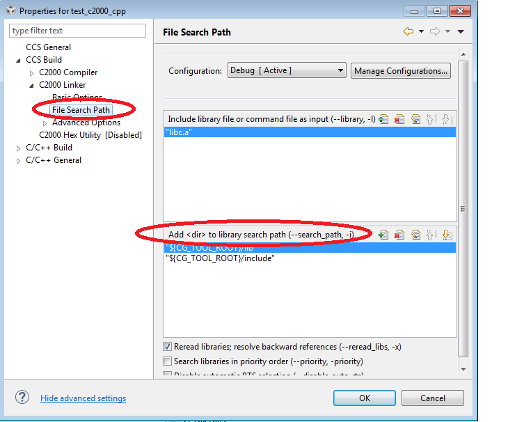

  • You cannot directly refer to a CCS variable from within the linker command file.  But I don't think you need to.  You could add something like ...
    ${CC26XXWARE}/driverlib/bin/ccs
    ... to the list of directories searched by the linker (see screen shot below).  Then you can use the methods described in the section titled Specifying Library or Archive Members as Input to Output Sections of the ARM assembly tools manual.
