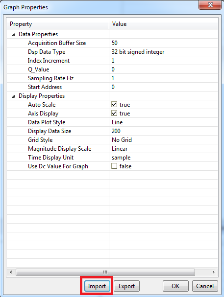

HI,...I want to plot the graph of ADC value in ccs. I am Able to see the graph but I have save the path of graph in particular file when I try to open that file it is not possible to open because the graphpro file extension. plz tell me if any tool or software is available to open this file.
    I assume you have a *.graphProp file, which contains the just the properties of the graph (and not the graph data itself). If that is the case, you can import that file from the Greaph Properties dialog:
    Again - note that all this does is import the properties saved in the file. It does not have any graph data stored in it.
    Hope this helps
