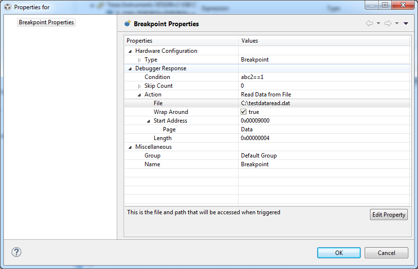

Hello everyone, I'm working with an array on Code Composer but I need to export its values to Matlab in real time. I want to know if there is a way to create a .dat file where I can only save the array values and modify the same file in real time (while I'm debugging the project) or if there is another way of doing this.
I'm working with Code Composer 4.2.4 and the TMS320 C5535 EZDSP
  • Set the following Breakpoint properties:
    1.  "Action" to either "Write Data to File" or  "Read Data from a file.
    2. Set "File" to the path and name of the file to write or read from.
    3.  Set the Start Address of the array to write to or read from.
    4. Set the length of the array.

  • Yes,it worked but now I have another question: how do I get the program back running automatically when it writes the data to the .dat file? and how do I import values from those files to another variable?
  • Hello Diego,
    "how do I get the program back running automatically when it writes the data to the .dat file? "
    The program shouldn't stop at the breakpoint if you set up the breakpoint properly (See example below).  When the breakpoint is reached, the debugger will wrtie/read data to/from the specified data file and then continue running the program.
    "how do I import values from those files to another variable?"
    The debugger copies the data file contents to the memory location specified in the breakpoint properties.
