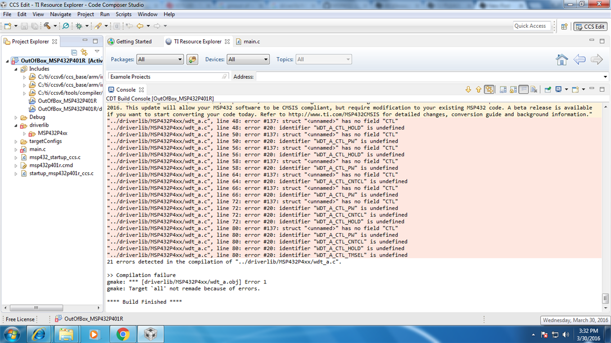

Compilation failure in CCS 6.2.1
I am new to code composer studio, errors occured while compiling the out of box demo. Not only this project, the same problem is with all the projects given in mspware/ TI Resource explorer. and code composer is up to date. Kindly find the attachment.
Plea se reply,
Anita
  • Anita,
    These errors are due to changes that were made to MSP432 header files to be CMSIS compliant.
    More information can be found in this wiki page: http://processors.wiki.ti.com/index.php/MSP432_CMSIS_Update
    For your use-case of importing and building examples from MSPWare, you would need to update both MSPWare and the "MSP432 Emulators" package to the latest versions, and then re-import and build the Out of Box project. Latest MSPWare is 3.20.00.37 and the latest MSP432 Emulators package (v6.2.2.0) can be installed from within CCS through menu Help->Check for Updates.
    Can you confirm which versions you are working with?
