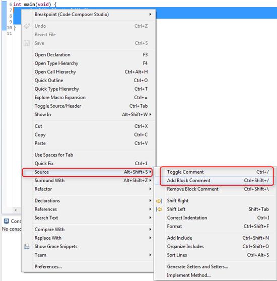

  • Good point.  The menus are a bit different version to version.
    This is what it will look like in v6.  Very similar to CCSv5.5/5.4.
