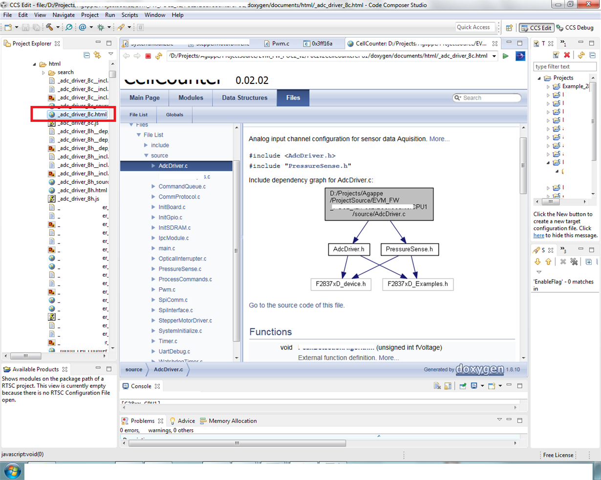

  • How do enable Doxygen output to display call graph??
  • You need to install appropriate Graphviz package to display call graphs
    -Aditya
  • I installed graphviz.....after that??? How do u set it up?
  • is it only for c++ and not for c??
  • I have installed doxygen ver 1.8.10 & graphviz ver 2.38. for my C code project in CCS. I am able to generate call graphs by configuring as per previous post attachment.
    Once we build documentation, call graphs were able to see on html pages.

  • Hi Akshay,
    Once you installed graphviz, you have to update graphviz path in .doxy file. The below attachment shows how to provide graphviz path.
    Please click on "Verify Answer" if it helps to resolve your query.  This may help others similar type of queries.
    -Aditya
  • i setup to execute the way u mentioned.. i got the same build log as u have displayed....but the html file generated has no call graphs?How do u view the call graphs?
  • im using doxygem 1.8.11 btw
  • Call graph looks like this.. from project explorer..
    If it is not coming.. pls check the settings in advanced tab of .doxy file.
    -Aditya
