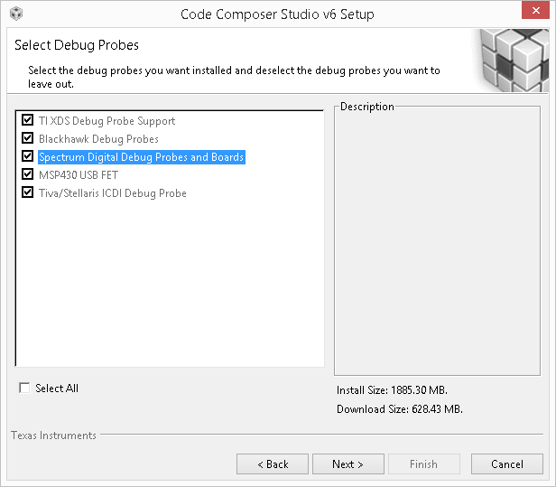

  • Darko Trogrlic said:
    Why cant I find the required connection?
    It looks like when CCS 6 was installed, support for the "Spectrum Digital Debug Probes and Boards" wasn't selected.
    It you re-run the CCS 6 installer and point at your existing CCS 6 installation you should be able to add support for the "Spectrum Digital Debug Probes and Boards" on the "Support Debug Probes" screen:
  • Darko,
    Thanks for sending the screenshot; as Chester pointed out, it seems you don't have Spectrum Digital support installed (it is disabled by default during CCS install).
    The procedure mentioned by Chester is also highlighted in section 3.1 of the wiki page below.
    http://processors.wiki.ti.com/index.php/Updating_CCSv6
