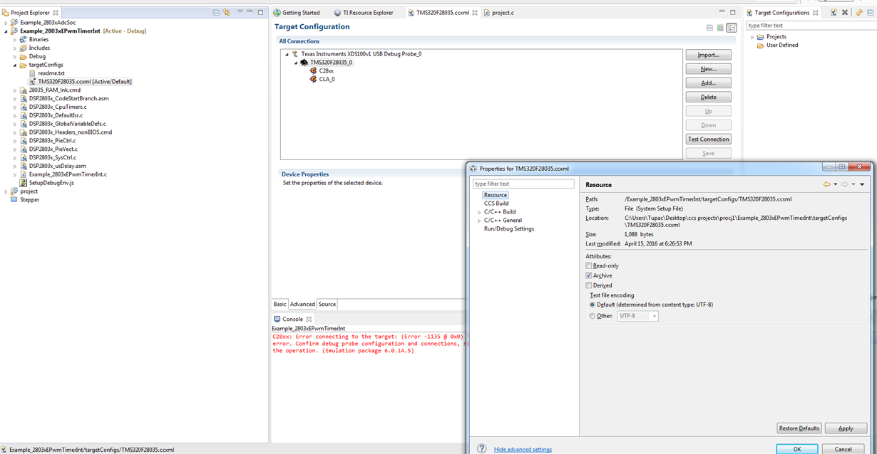

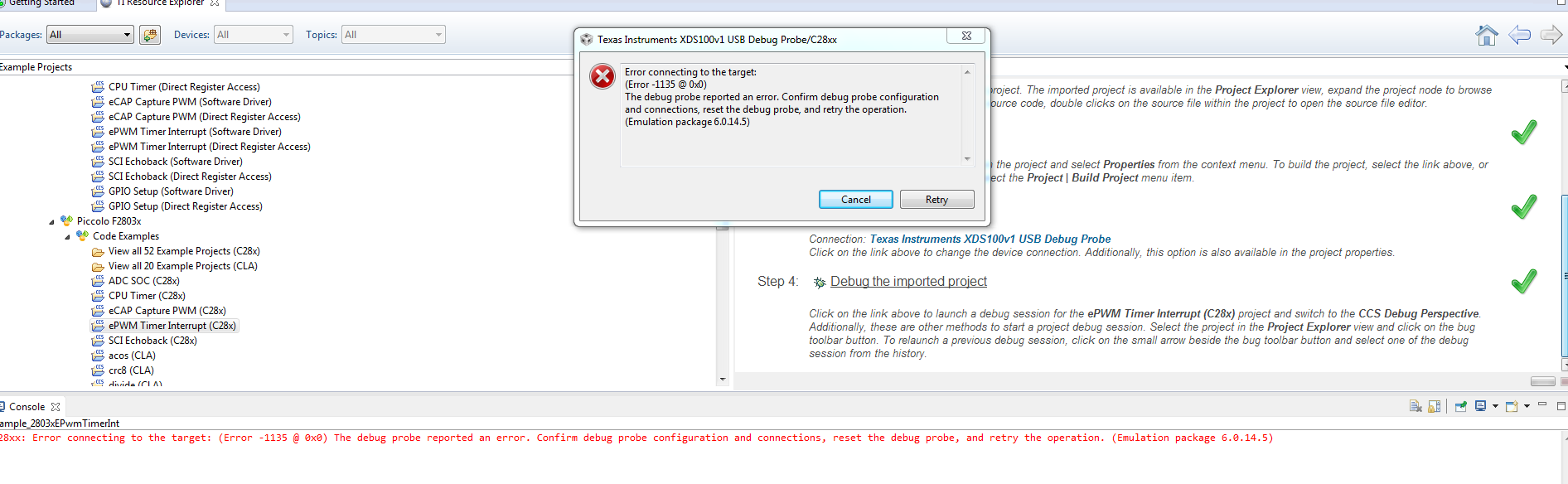

C2000(Piccolo Control Card)Error connecting to the target: (Error -1135 @ 0x0)
Other Parts Discussed in Thread: DRV8412, CONTROLSUITE
I am using a DRV8412 C2 Kit Motor board, and a Controlcard that has a C2000 (F28035) Piccolo MCU. I am having problems with connecting to target.
Error Below :
(Error -1135 @ 0x0)
The debug probe reported an error. Confirm debug probe configuration and connections, reset the debug probe, and retry the operation.
(Emulation package 6.0.14.5)
Console Error:
C28xx: Error connecting to the target: (Error -1135 @ 0x0) The debug probe reported an error. Confirm debug probe configuration and connections, reset the debug probe, and retry the operation. (Emulation package 6.0.14.5)
When I go to Test connection. the .ccxml file error pasted below:

I don't know how to fix this. I tried both V1 USB and V2, without connecting to the target, I can't run any code for Motor Control.
  • Is it possible to Factory reset the MCU, Maybe the MCU setting was changed and thats causing the linking error.
    The issue reported by the Test Connection is explained in the post below:
    e2e.ti.com/.../1629574
    Based on your development kit definitely the connection you need to configure is a XDS100v1. You also need to be sure that all jumpers are properly set and the board is powered correctly. For details check the "How to Run Guide" of your board. If you have controlSUITE installed, this guide is located under C:\ti\controlSUITE\development_kits\DRV8412-C2-KIT_v131\~Docs
    The reason is that the controlCARD that comes with this kit uses a galvanically isolated XDS100 JTAG debugger, which does not automatically provide power to the DSP just by connecting the USB cable (which is expected).
    Hope this helps,
    Rafael
  • Thank you for the reply.
    I was able to fix it by changing switch 3 on the MCU downwards since I was using CCS. The problem I am currently having is my code currently brings a fault in the DRV8412 board "the fault red LED turns on"
