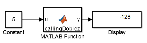

I want to ask for your help to understand this problem. I need to make a converter from float value to string, to be send by serial transmit of my Tiva C launchpad. Im trying to make the conversion in a simulink function block using the sprintf function.
During the debug in the Code Compiler Studio it works fine, I only receive a warning that the return variable are not compatible with the format, but the value gets saved to the char variable.
The problem ocurr with Matlab, because regardless the value of the constant, the block always give me the value of -128; I was searching for hours, but i can't found any solution.

Function block code:
function y = callingDoblez(u)
%#codegen
y=0.0;
y =  coder.ceval('doble',u);
Diagram:

  • Hi, thanks a lot for your answer;
    After the modification the warning disappear, but now I have an error:
    Building with 'MinGW64 Compiler (C)'.
    C:\Users\Alberto\Desktop\slprj\_sfprj\untitled\_self\sfun\src\c2_untitled.c: In function 'sf_gateway_c2_untitled':
    C:\Users\Alberto\Desktop\slprj\_sfprj\untitled\_self\sfun\src\c2_untitled.c:180:10: error: incompatible types when assigning to type 'double' from type 'char *'
       c2_b_y = doble(c2_b_u);
    gmake: *** [c2_untitled.obj] Error -1
    Component: Make | Category: Make error
    Unable to create mex function 'untitled_sfun.mexw64' required for simulation.

  • Are you sure the display requires a string. Also, could you post c2_untitled.c?
    What is the data type of c2_b_y?
    Stephen
  • Well the unique way to use the serial transmitter block is with variable like [1 2 3] pr double('123'), any other format send me the Ascci value and is not usefull for the application.
    The c2_b_y it's a data generated by Matlab because I only have the doblez.c code.
    The file c2_untitled.c was generated by Matlab and it's a huge file, this is the last part where the error appear:

  • I don't understand the problem with the file generated by Matlab, because in the debuging in CCS all works fine....
    I'm using the display to check the value of the function block output, once I obtain the correct value I will remove it and use the serial transmitter.
    I need to comunicate two Tiva C by UART using the Serial Transmiter developed for this launchpad, the block is the Serial Transmitter for Energia, it only accept value in Unit8 format. The problem is if I read a value of a sensor with value 123 and send to the Serial transmitter, It will send a { because it's the Ascci code for it, and if I send a balue of 123.54, give me a lot of symbols that can't be interpreted in the receptor.
    But If I use a constant generator with the value: double('123') I will receive the value 123. Also If I make a block that generate a char with [1 2 3], and send to the serial transmitter I will receive the 123 again.
    So, This is what I want to try to make
  • If you want to view a string of character, you can't use the Display Block.
    Why not have the function block  output two values, an integer (use atoi()) and a string. The integer value could be displayed on display block and the string could be transmitted.
  • You could also use two function blocks: one that outputs a string to the serial transmitter and one that outputs an integer to the Display block.
  • I agree, the problem is that I need to make work the code in the block to generate the string....
