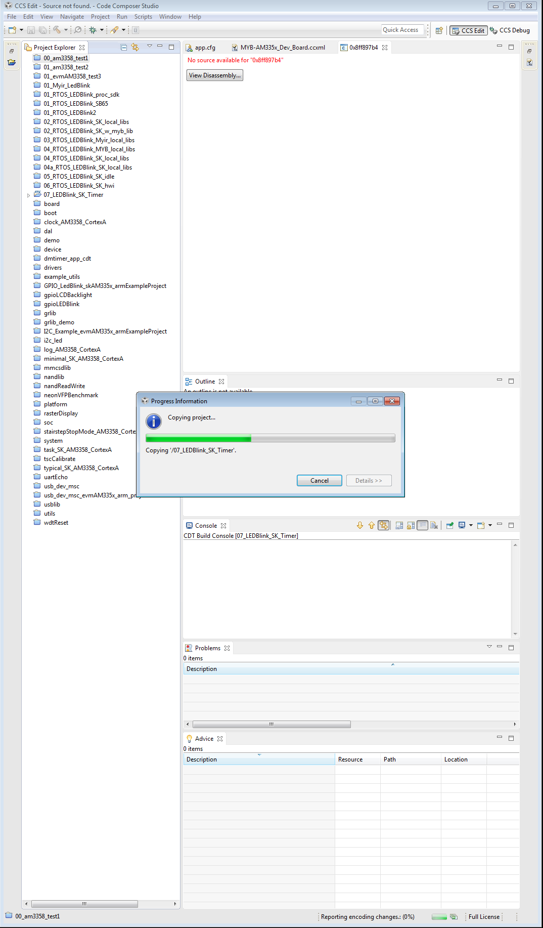

However, when I try copying this project (07_LEDBlink_SK_Timer.zip   which still compiles and works properly on my AM3358 Starter Kit board), it proceeds for a couple of seconds and then hangs, using up about 25% of 3 (of 4) cores on my PC.  And even left for 30 minutes, it never proceeds past this point.
PC Core Load:
Here is a screen shot:
Of possible relevance is the status message:
When I try to kill the process, I get the Windows Blue Screen of Death, it does a memory dump, and then my PC reboots.
Because of this, I cannot test at this writing whether it behaves the same on other projects (since CCS is hung, and does not respond at all -- even to the Cancel button on the "Progress Information" dialog box -- except to disable the Cancel button).  I will try copying another project next.  Now it is time to save all my documents and close other applications because I'm going to get the Blue Screen of Death again.
Can anyone help me sort this out?  Move the workspace back and import the old project(s) into the new workspace?

    I think it is a problem with the actual routine that does "Reporting encoding changes".  Here's why:
    1.  I have mixed files in this project:  at least the .S file uses CR/LF pairs for line endings, whereas most, if not all other files use only LF.
    2.  I created the new workspace (on an empty folder) as you suggested and imported the project (07_LEDBlink_SK_Timer) and it imported and built without any errors.  Then I cleaned the project to reduce copy overhead, and then...

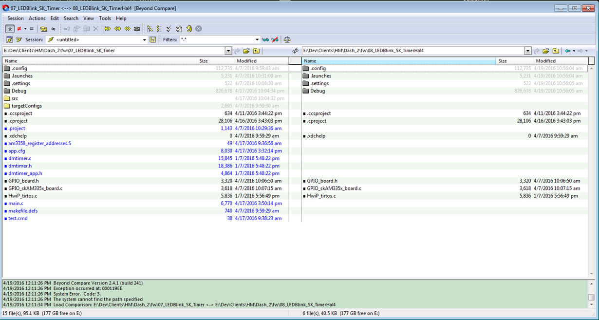

    3.  I did a COPY of the project in Project Explorer, and then a PASTE, and it gets to the same point and hangs, again with the "Reporting encoding changes" status message.
    The following is a screenshot showing the new directory created and a comparison of the files.  You can see that some source files have been copied and others not, and I believe it is in this process that something (a file encoded differently?) is triggering the "job" "Reporting encoding changes", and then, according to the bits of some of the Eclipse bugs I read, one thread takes over and nothing else will happen until that thread completes, and it doesn't complete!  I have tried letting run for as long as an hour now.  I'm going to do the same on the new workspace to see if it will actually finish.  But whatever this "job" is that it is trying to do, it is ... hmmm...  shall I say it?  an engineering disaster, and appears, according to the bugs I read, to have been around since 2005.  Most of the bug reports end off (get closed) with "unable to replicate"!  Do a Google search on the QUOTED string "Reporting encoding changes" and read the Eclipse bugs found and see if you concur.
    Meanwhile, here the screenshot showing the file DIFF:

  • Hi Victor,
    We were able to reproduce the problem, and know the root cause of it.  This is a bug in Eclipse.  It is the same bug as the one reported in https://bugs.eclipse.org/bugs//show_bug.cgi?id=339859.  I will try to implement a workaround for it for CCS v6.2.0.  I have opened a Jira entry to track this issue: https://jira.itg.ti.com/browse/CCDSK-469.
    This problem affects any project that has linked files/folders relative to any path-variable.  You can see all the path-variables for a project in the Properties > Resource > Linked Resources dialog page, on the Path Variables tab.  The same page also shows all the linked resources on the Linked Resources tab.
    The only workaround i can think of right now is for you to manually copy the project using an external tool, like Windows Explorer.  Once you've made the copy in the filesystem, you'll need to also edit the .project file to adjust the <name> element to reflect the new project name.
