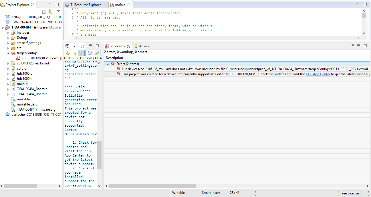

I am trying to use TIDA-00484 Firmware as an example in  CC1310 development board. But  this errors appears. Can you help me to fix that please ?
ERRORS:
1)Description Resource Path Location Type
File devices/cc1310f128_rev1.xml does not exist. Was included by file C:/Users/eyup/workspace_v6_1/TIDA-00484_Firmware/targetConfigs/CC1310F128_REV1.ccxml CC1310F128_REV1.ccxml /TIDA-00484_Firmware/targetConfigs line 0 Problem
2)
This project was created for a device not currently supported: Cortex M.CC1310F128_REV1. Check for updates and visit the <a href="liveaction:OpenAppCenter">CCS App Center</a> to get the latest device support, or migrate the project to closest matching supported device by adjusting project properties. TIDA-00484_Firmware project Problems
    I suspect this design was created using an outdated or internal device support for CCS (the _rev1 in the name of the missing filename is a dead giveaway).
    1) In this case, I would simply double-click on the .ccxml file and correctly set it to the CC1310F128 device (without any Rev1 suffix).
    2) This is a similar scenario as above. Go to the project properties and, in the General section, change the device from CC1310F128_REV1 to CC1310F128.
    Hope this helps,
    Rafael

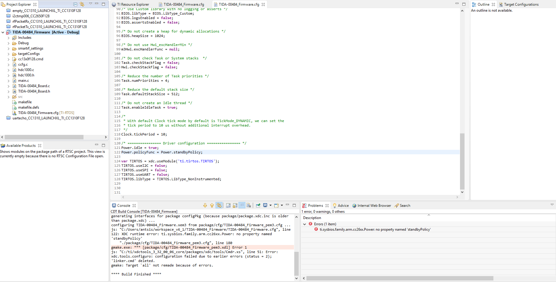

  • But ı got this errors. If you know how to get rid of this errors please help me.
    Is the Language settings on your PC set to Turkish? If yes, could you take a look at the response to your post here?
  • Yes. The problem is Windows language thing. I' m built in another system in English version Windows. And I did what desouza say exactly. I get this one error. Could you help me on this please ?
  • Which version of TI-RTOS are you using? It seems that the firmware project for TIDA-00484 is not compatible with TI-RTOS 2.16.0.08. According to the readme.txt file that gets installed with the TIDA00484-Firmware, it has been verified to work with TI-RTOS 2.14.03.28.
    When building with TI-RTOS 2.16.0.08, I see the same error that you reported (no property named standbyPolicy), but with TI-RTOS 2.14.03.28 it builds fine. Please download and install that version of TI-RTOS and set your project to use that.
    If you continue to have issues with this, I would suggest posting to the Simplelink device forums as they are the developers of the TIDA firmware package and should be more familiar with version and compatibility issues.
