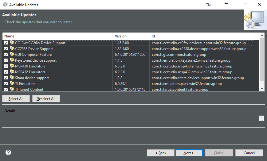

I installed the full version of Code Composer Studio (v6) and managed to update most of the components, however there are some components, which refuse to update. The screenshot below shows the components, which refuse to update, though I receive notification that there is an update.
Here is a screenshot of the errors:
Here is a copy and paste of the error.

Basically, I get the "No repository found" error, but I do receive update notifications, so how can I tell Code Composer Studio (CCS) where to find the repositories?
Where are the repositories?
Why does CCS not know where the repositories are, when CCS installed everything? I just selected the install all option. CCS did the rest.

    The list had some of the components, but not all. I selected the components that I could (about half) , proceeded to install, and received the error message above. None of the components requiring an update updated. Basically, no go.
    I deleted the cache directories.
    Here are some screenshots.
    and
    Thoughts?

    I still receive the "No repository found" error message.
    A fresh "check for updates" still show the same thing. I might add that in some cases there are repeats of items, so in those cases I usually chose the first item.

  • I selected all the components needing an update at the same time. Let me try one at a time. If not, then WebEx or TeamViewer. I did not realize that you want me to do the procedure once for each component. Stay tuned.
  • Hi Danish, interesting. If you select just one component, you get all the components needing to update for free; kind of a buy zero/one and get all the ones needing an update for free, BOGM (not BOGO, as I have several components). The problem is the same. no change.
  • Danish on WebEx was able to replicate my findings in a newly created project. Danish sent off the log file to developers. The error came way, way too fast to be a no repository found error. Additionally, if CCS (Eclipse) could not find a repository, then Eclipse (CCS) would not have been able to know that there is an update.

  • Danish had me try the following. I am copying and pasting what she wrote me in email form.
    While the devs are looking at the logs can you try the following to force the metadata to be written?
    1. Go to Window -> Preferences -> Install/Update ->Available software sites
    2. For each site that’s enabled (check box checked), click on it and click the reload button.
    3. Click on ok and exit out of CCS.
    4. Try updates again.
    Result:
    Same error; same update list after install, same everything, no change.
  • Per Danish's request:
    Could you please go to Window -> Preferences -> Install/Update ->Available software sites and take a snapshot of the sites you have enabled?
    The dev here says one of the custom theme updates (from eclipse, not CCS) you’ve done previously seems to be complaining, but that might not be the only problem.
    One suggestion, which is a pain in the neck, I know, is to install a fresh copy and do the updates, and see if that’s still causing problems.
