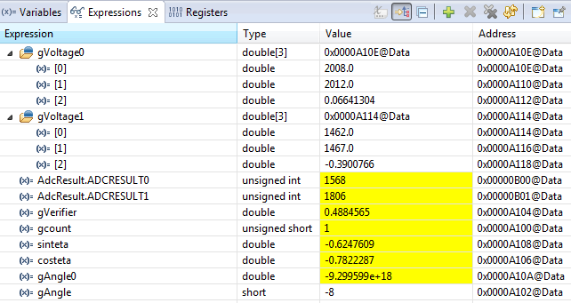

I am programming microcontroller TMS320F28069M in order to read the value from a Hall capteur which sends to me 2 signals analogic sin and cos.
We can consider that the signals have  the form:
S = A1. sin(Angle) + offset 1   and         C = A2. cos(Angle) + offset 2
You can see a part of my code here

gAngle0 =  (atan2(sinteta,costeta)*180)/PI;
gAngle =  ((int16) gAngle0) % 180 ;
"float16" is actually "double" data type
The results  through Debug:
So, I used the atan2 function to calculate the angle, but the problem is that values of the Angle are expanded to its limits of data type. You can see that "Angle0" has the value of 1.231e+9, far more away its true value -41.76 degree. I tried the steps to calculate angle with atan2 in different program ( C-free 4.0) and it works well without problems in CCS.
What do I have to do to solve this problem ? Add or include some special libraries to CCS

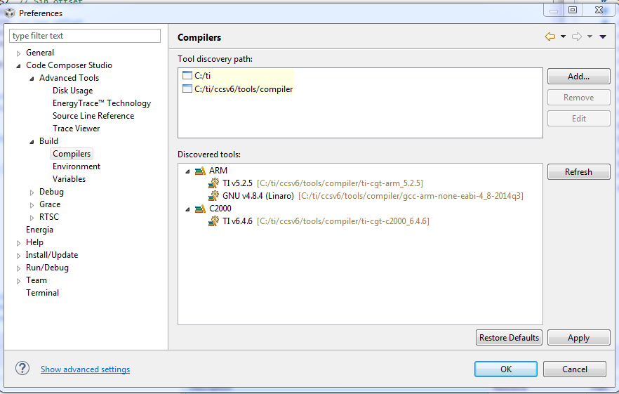

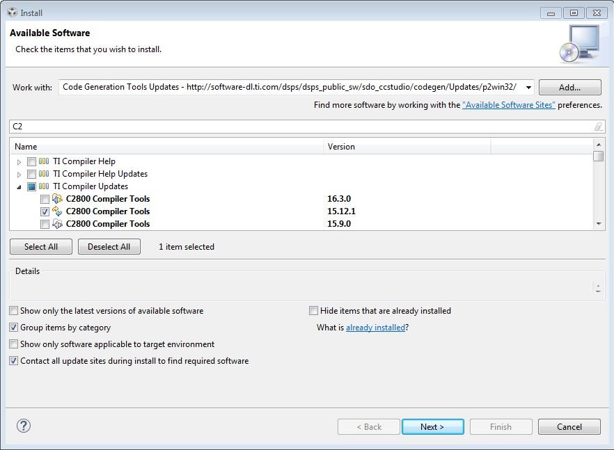

  • I think that I find out the problem, in the preference window, I cant find C2000 compiler version 15.12.0.LTS existing. So maybe the installation has the problem. So how I can update my compiler ?
    I used "Install the new software" with the option "Code Generation Tools update", but the site of ti refused my connection. Do you have any solution ?
    There are multiple sites to choose from for updating the compiler.  Try another one.  See this screen shot below.
    Thanks and regards,
    -George
  • Looking at your screenshot, I see you are using C2000 compiler version 6.4.6. Using this version, my test case operates as expected, so we have not yet established that upgrading to 15.12.0.LTS will improve your example.
    On C2000, the type "double" is only 32 bits. I don't see any 64-bit arithmetic in your example.
    Please show us your complete command line options from the build console window.
  • Like you said, somehow after updating the compiler v15, it changed nothing. In fact, it updated value of Angle0 faster, but sended numbers out of range. Really  weird.

  • Did you really implant your code in a microcontroller ? because when I use your code calculating atan2 with a microcontroller and with different programs, it doesn't work. But if I run seperately it , without implantation, like you have done, it works. So maybe the problem is that CCS compiles in wrong way for microcontroller.
    If you noticed, I have said the value of variable is extended by its data type. So i don't know if data type is also a problem
  • No, I ran the executable under a simulator so that I could use printf. This demonstrates that the compiler is generating correct code for atan2. The compiler doesn't generate code differently if the code will be embedded.
    The correct value for gAngle0 (approximately 41) easily fits in range for a 32-bit float variable, so there should be no issues with whether you use float, double, or long double.
    Perhaps CCS is displaying the value of gAngle0 incorrectly. Please show us the memory window view of gAngle0 when CCS shows its value as 1.23e+09.
  • I run my code with the new compiler v15, and here is the memory window for all variables.
    The strange here is the microcontroller use the wrong number of Angle0 to calculate Angle.
  • Update: Finally, I found out the problem, how stupid am I. In fact, by default, the program implant on F28069_ram, but for my case, I have to change it to F28069M_RAM to use with the lauchpad, so the ram configuration is different. That's why the function atan2 returns wrong values. I had checked forum C2000 and in the end, luckily, find a comment in an irrelevant topic which also solve my problem.
