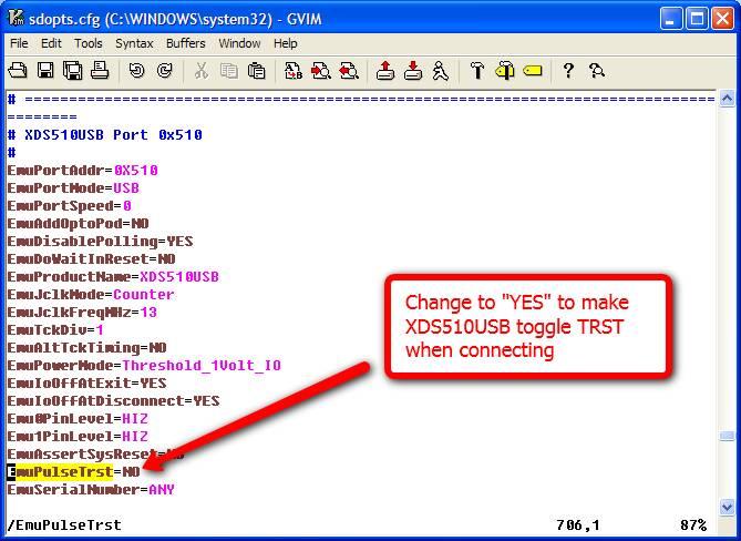

Unstable debugger...
Again C5509A with CCS4.0x and CCS4.1x
Before we start CCS 4.x we must always first use the SDConfig for the DXS510 USB, Plus to reset the target. If not then CCS4.x can not connect to target.
The SDConfig ALWAYS works, 100% stabile grate software, however CCS4.x normally works, but often we can not connect at all. Then exit, reset sometimes reboot the PC, some magic walking to the coffee machine, and then it works again!!!!!! Or not……
This is frustrating when you are concentrated on a customer issue…
Ideas????
