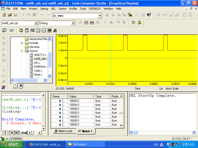

C6713 DSP (CCS3.1v) graphing error
I would realize the AD&DA using a daughterboard.
I input the signal of square wave from the function generator. (10Hz, 5vpp, offset 0)
I wanted to confirm the input signal the board receiving. So I viewed the configure the square wave. but something weird...

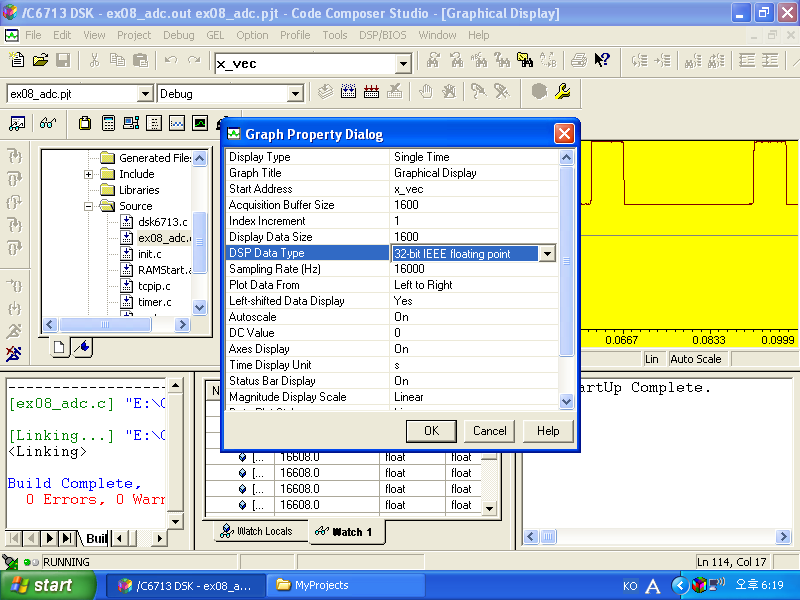

There are many DSP data types I can select like 32bit singed integer, 16...8... and 32 IEEE floating .. and so on.
What should I select?
The company member delivered the Daughtercard said the Input signal would be treated as 16 bit and the Output signal would be treated as 12 bit.
But someone said me the DSP data type for the graphing is under the header file and c file.
Anyone else can tell me that
I made some mistake in code or graph setting? or... any other mistakes?
have a nice day!!
    The DSP data type setting in the graph properties should generally be set to match with how the variable is defined in your code.
    Also, the version of CCS you are using (v3.1) is very old and no longer supported, so please understand that the amount of support we can provide for this version is very limited.
