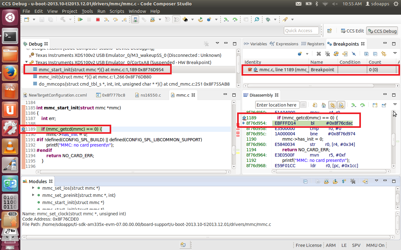

Yet when I set a hardware break point on functions (for example, mmc_start_init in mmc.c), the processor halts (after I run "mmcinfo" at the console prompt).

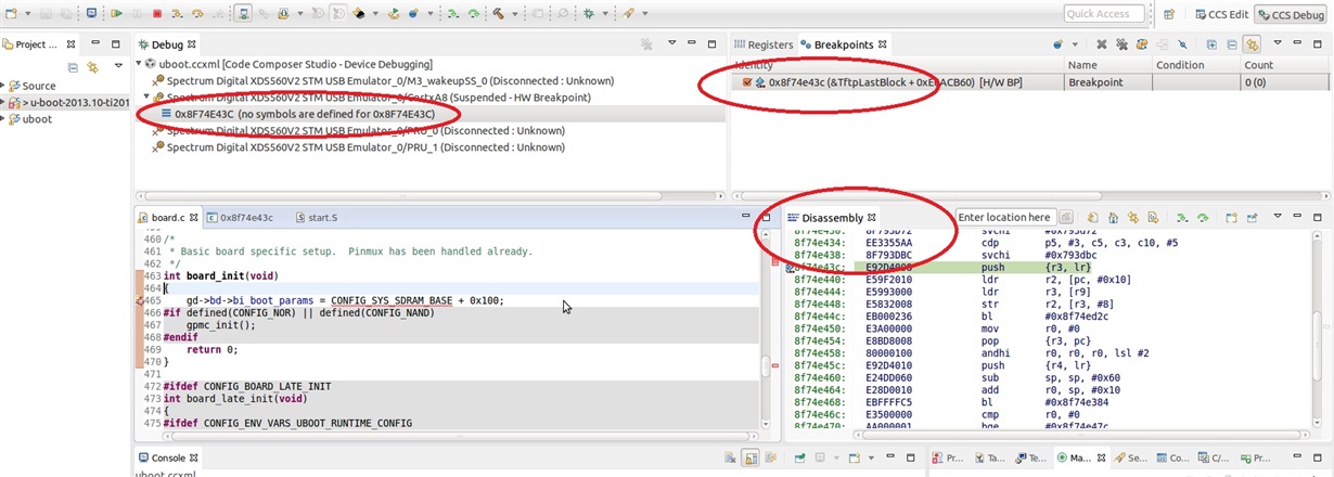

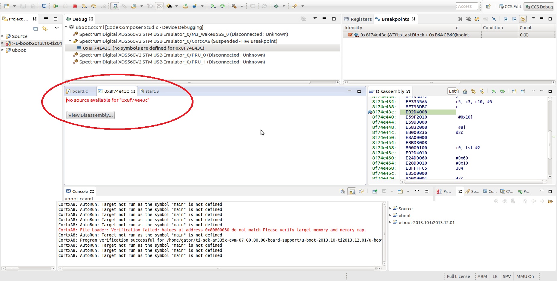

But I get a "No source available for "0x8f76d784"", the disassembly window does not show my source.

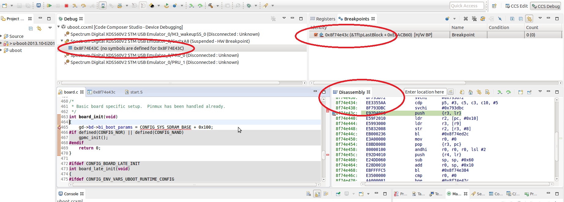

I did what the instructions said and I loaded the symbols (u-boot) with the code offset (and data offset) set to the value displayed at relocaddr from the "dbinfo" command.
Anyway ideas on why I am unable to see my source when the hardware breakpoint occurs?
