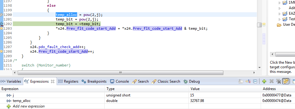

I am using TMS320F28377D for my inverter application. In my software i have to use power function. Which is defined under math.h as "double pow(double x, double y);".
I have noticed strange behaviour of pow function. For Example,
pow(2,14) returenes = 16384. (OK that is fine)
But, pow(2,15) returenes = 32767.98 instead of 32768.
I can not accept this minor change please suggest any solution. I have captured image as i observed and that is attached herewith.

    I haven't investigated the accuracy of the floating point pow() function, but notice that your code raises 2 to an integer power.
    In which case, the example could instead use a shift. e.g.:
        temp_bit = 1 << j;
        temp_bit = ~temp_bit;
    Is an integer shift suitable for your program?
