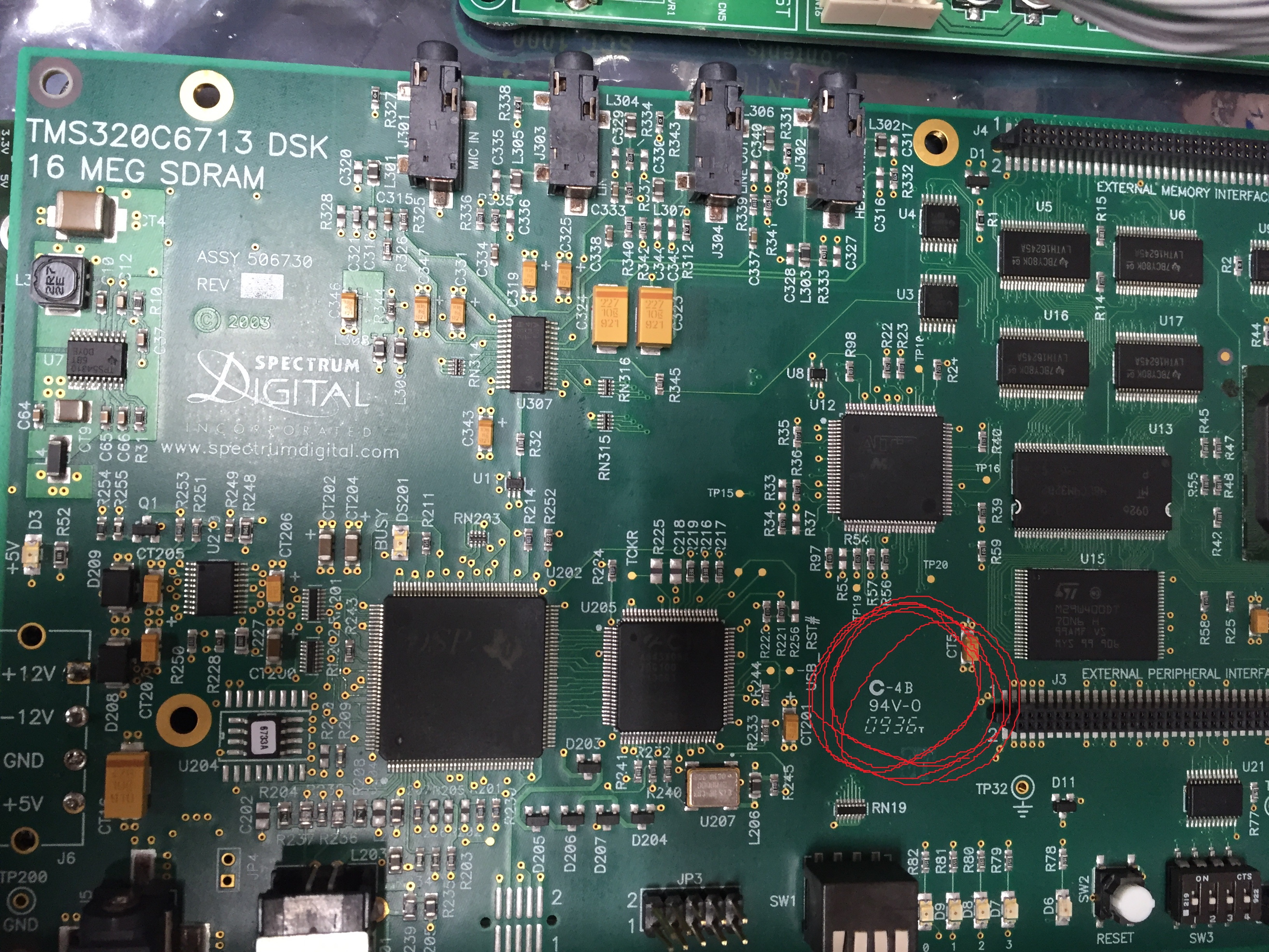

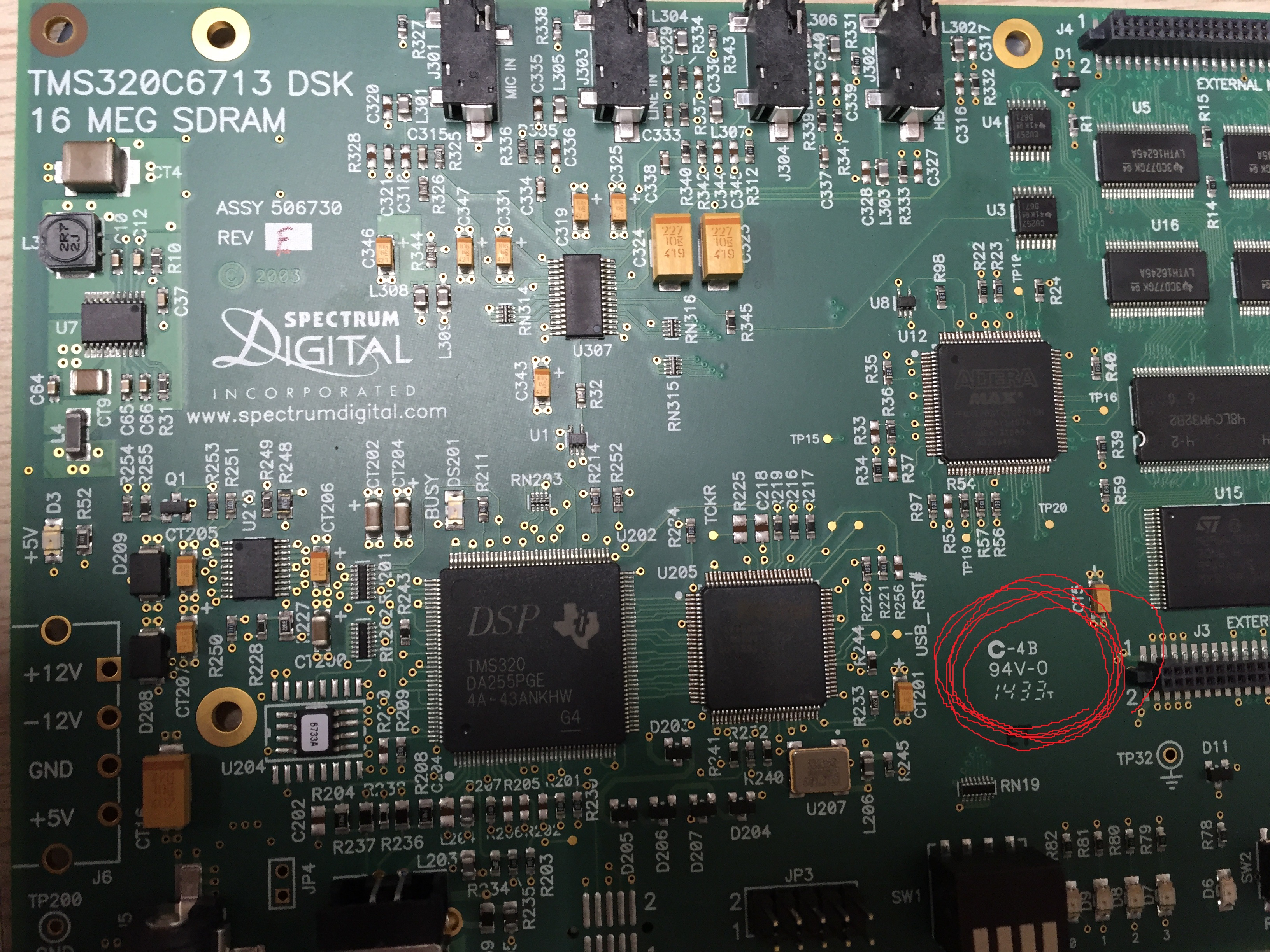

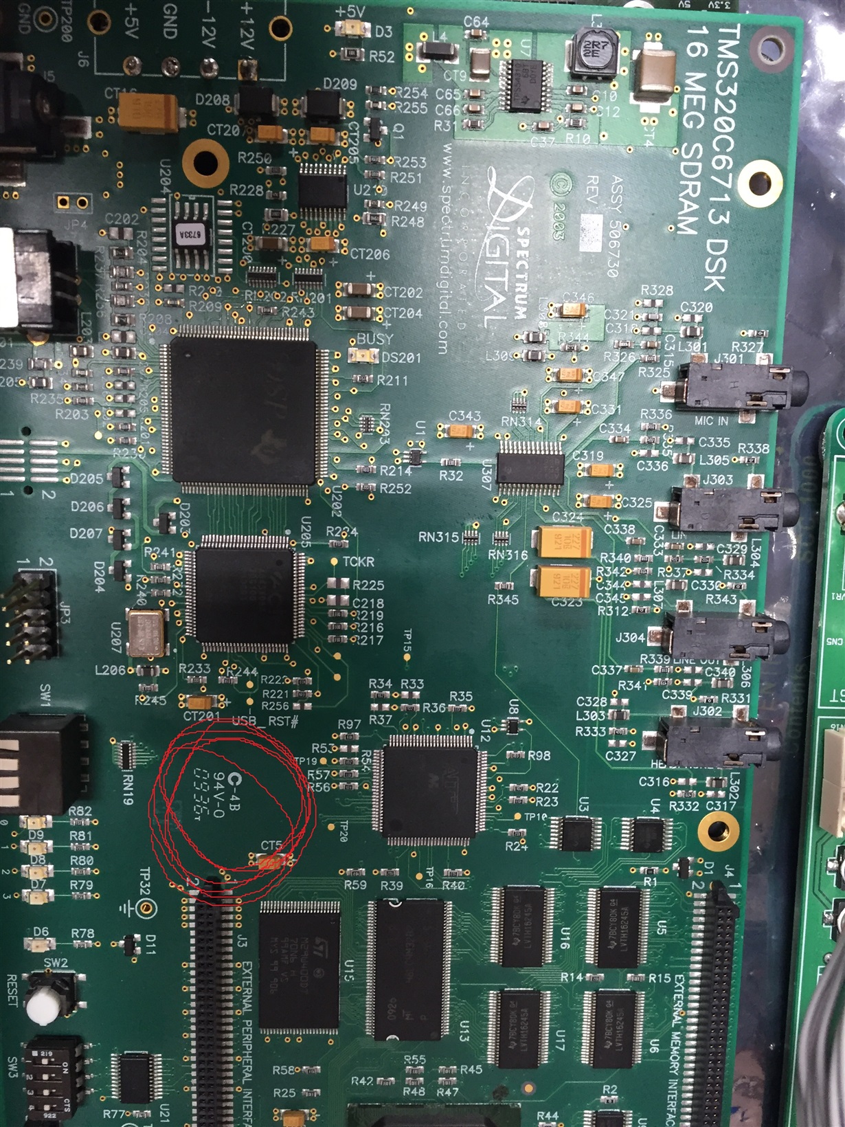

I bought new TMS DSPBoard c6713.
But I have a Q.
Is there any different function between the boards??
    This is most probably the Printed Circuit Board (PCB) manufacturer's information - for example, 94V-0 is the designator for flame retardant material. C-4B may be the name of the PCB manufacturer and the other may be just a serial number.
    If you want to spot differences in the design, check what is marked in pen at the "Rev" spot - the last board is Rev E, but I can't see what is written in the first picture.
    Spectrum Digital's support page only lists Rev C, therefore I would expect the documentation that came with your new board should reflect what is changed in your board revision. In any case, please contact Spectrum Digital if you can't find this information.
