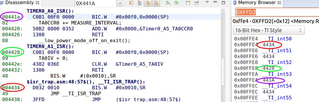

I have a piece of code that uses interrupts. Generally, the values of the interrupts are saved in the ELF file in sections called RTC, PORT2, TIMER2_A1 etc.
When flashed, those values are copied to the interrupt vector table at 0xFFD2.
However, in my relocatable file, the sections have value 0, and their relocations ALL point to __TI_ISR_TRAP, when the TIMER0_A1 and TIMER0_A0 should point to my functions.

Any ideas ? Can someone reproduce it ?

EDIT: Just in case, this is how the normal ELF looks like.

  • I won't be able to copy/paste it until friday, however, the argument I used to make it relocatable was --relocatable. Actaually, I just added -r and it changed to --relocatable automatically. I guess it recognized it.
    However, the values being 0's is not a problem to me. The values on other sections before perfoming the relocations are also 0. The problem is that the relocations regarding the interrupt sections are wrong. I expected something like this:
    Relocation section '.relTIMER1_A1' at offset 0xc508 contains 1 entries:
     Offset     Info    Type            Sym.Value  Sym. Name
    00000000  0005a702 R_MSP430_ABS16    00000034   TIMER0_A1_ISR
    Relocation section '.relTIMER1_A0' at offset 0xc510 contains 1 entries:
    00000000  0005a702 R_MSP430_ABS16    00000034   TIMER0_A0_ISR
    Instead of all of them pointing to __TI_ISR_TRAP:
    00000000  0005a702 R_MSP430_ABS16    00000034   __TI_ISR_TRAP
    Hope it´s clearer now.

  • Just wanted to say I tried to reproduce it again and it did happen again. I just created a proyect that blinks a LED using a Timer (interrupt) and the same problem appeared.
    There are many workarrounds I could try, however, is this a bug ? Can someone confirm before I start solving it in another way ?

  • No, this is the right forum. I haven't been able to get to this because I'm not immediately familiar with how it works, working with relocatable executable files is not technically a supported mode, and I've got lots of other issues that need to be addressed. I suspect the others who watch this forum are in pretty much the same situation.
  • I apologize for the delay.  This took more research than is typical.
    A file linked with --relocatable (or -r for short) can be linked again.  But it is not ready for execution, just like an object file created by the assembler is not ready for execution.  ELF does provide for building dynamic executable files, but this capability is not supported for MSP430.
    Thanks and regards,
    -George
    (1) What do you mean ? After I link/relocate all the addresses in the code I can run it. I have already done it before. I don't quite get the comparison here.
    Still, it's weird that other relocations work like a charm, (2) did you find out why isn't it working ? (3) Did you check the linker code or something ?
    (4) Any chance of getting it fixed in the next release next month ?
  • 1) Right, *after* you relocate it. Before you relocate it, it won't run.
    2) George is referring to "dynamic shared object" support, which is simply not implemented for MSP
    I don't understand, how is this related to why the relocation works on some sections but doesn't on others ?. I am not using shared mode, I am using relocatable mode.
    https://en.wikipedia.org/wiki/Executable_and_Linkable_Format said:
    0x10 2 e_type 1, 2, 3, 4 specify whether the object is relocatable, executable, shared, or core, respectively.
    Thanks.
  • George is not addressing your question directly. He is telling you that the overall path you are taking, a "relocatable executable file" is not a mode that is intended to be supported in ELF files; in fact, no such mode actually exists. "DYNAMIC relocatable executable files" (aka shared object files) are the industry-standard solution to the sorts of problems you are trying to solve. However, the TI MSP compiler does not support this feature.
