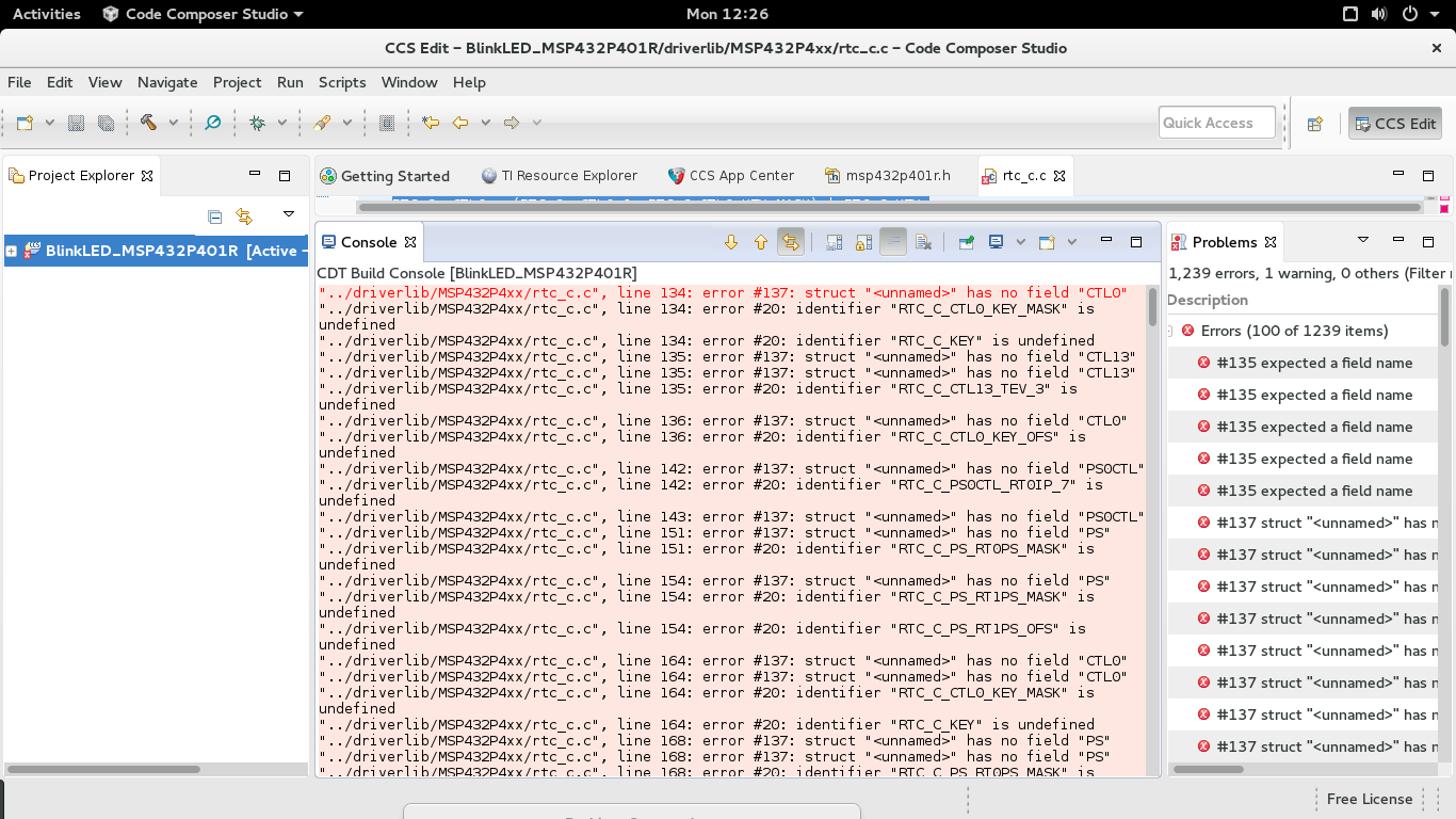

Kindly find the attached screen shot. The same project when build on window7 their is no such problem.
why this is happening not understanding. Please reply.
Anita,
Please make sure you are using the latest versions of CCS (v6.1.3) and importing the project.from the latest version of MSPWare (v3.30.00.18). This type of build error may occur with a certain combination of older CCS and MSPWare due to the migration to CMSIS compliant code.
