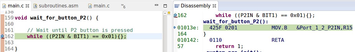

Was this compiled correctly ?
I wanted to write a code that would wait for a button to be pressed. This is my code and the compiled result.
For some reason, my while statement has been compiled into a (MOV.B + RETA) instruction set.
I cleaned the project several times, restarted the CCS but it still remains there.
Any idea why this is happening ?
Thank you.
P.S.: This code is working perfectly on another project.
if ((P2IN & BIT1) == 0){
    red_on();
  • This source line ...
    while ((P2IN & BIT1) == 0x01) {} ;
    becomes this after preprocessing ...
    while (((PAIN_H) & (0x0002)) == 0x01) {} ;
    And PAIN_H has this definition ...
    extern volatile unsigned char PAIN_H;
    I can see all that by building with --gen_acp_raw and then inspecting the resulting .rl file.  The compiler can see that, no matter the value of PAIN_H, after anding with 2, it will never equal 1.  Because PAIN_H is volatile, it still issues the read instruction.  Then it returns.
    So, that is what is happening.  I don't know enough about programming MSP430 to tell you how to fix it.
    Thanks and regards,
    -George
  • Oh God, you are right, the solution is easy though:
    while ((P2IN & BIT1) == 0x02) {} ;
    After ANDing 0x02, compare it to 0x02, not 0x01.
    Thanks, it's working now.
