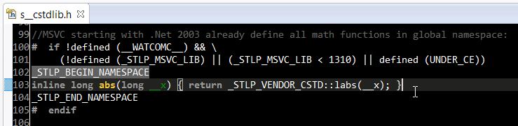

I'm currently having trouble compiling a project targeted for a TM4C129 with v15.12.2.LTS and 16.3.0.LTS of the TI ARM C compiler. It compiles fine on v5.2.7, but I get the errors below on the latest 2015/2016 compilers. Could somebody direct me as to why these are being redefined?
  • That code is only meant to be compiled if you are compiling a file as a C++ file, but based on the options shown, you aren't compiling in C++ mode. This code is guarded by conditional compilation directives that should prevent it from being compiled in C mode. I see you also have a warning message about an incompatible redefinition of _STLP_VENDOR_CSTD, which is quite alarming to me; you should not see any redefinitions of that macro. Something is wrong with the definition of macros in this program, but I can't determine exactly what.
    Please compile just that C file with the same options, but add the option --gen_acp_raw
    This will create a file that will help us debug the problem.
