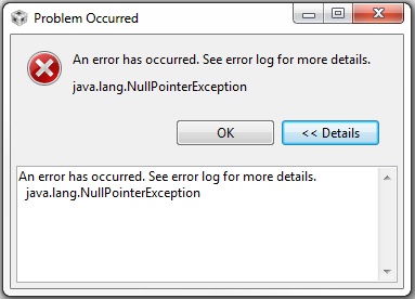

I can not use project properties windows of any project properly . When I open the project properties from project explorer, two windows are opened with the name of "Properties for **projectname**". I closed one properties window. The other one is still open. After I click any of properties steps, I meet some errors.
For example, after I click "Build" step, I meet the following window:

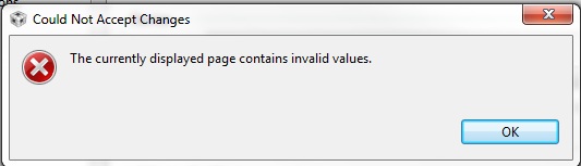

After closing this window, click "ARM Complier" step and the same error occured. After click OK button on this window, the following window is showed:
To solve this problem, I uninstalled the CCS software. After that, I reinstalled the CCS, but there is no change.

    Before format the pc, I upgraded windows 7 to windows 10.
    Upgrade to windows 10 solved all problems that I mentioned above.

    I had the exact same issue. After digging around, around and around, I have found out that the issue was resolved by disabling NVIDIA nView Desktop Manager. (I'm using Dual Monitor Setup)
    The resolution was found since I was searching for a notepad++ issue, which was minimizing on copy actions. When I found that disabling nView Desktop Manager resolved the notepad++ issue, I checked code composer studio as descibed by ahmet bakır, and found out it also solved this issue.
    I already saw in the eclipse error log (located in the .metadata folder) that it had to do with some displaying issue:
    !ENTRY org.eclipse.jface 4 2 2017-04-18 14:59:00.262
    !MESSAGE Problems occurred when invoking code from plug-in: "org.eclipse.jface".
    !STACK 0
    java.lang.NullPointerException
    at com.ti.ccstudio.project.ui.internal.properties.DynamicPropertiesPageManager.showToolchainNodes(DynamicPropertiesPageManager.java:483)
    at com.ti.ccstudio.project.ui.internal.properties.DynamicPropertiesPageManager.access$10(DynamicPropertiesPageManager.java:476)
    at com.ti.ccstudio.project.ui.internal.properties.DynamicPropertiesPageManager$PropertiesDialogSpy.forEach(DynamicPropertiesPageManager.java:295)
    at org.eclipse.cdt.ui.newui.AbstractPage.cfgChanged(AbstractPage.java:1010)
