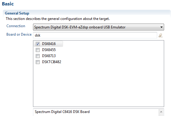

I want to run an example for TMS320C6416 DSK using CCS v6. There is embedded JTAG emulator on the board.
Target Configuration is:
But debugging isn't start. An error is "Error initializing emulator".
I think drivers for USB emulator are needed. Is it correct? Where I can find these drivers for CCS v6? There are only ones for CCS v4 here: http://support.spectrumdigital.com/
