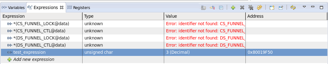

    If you right-click on a variable in the Expression view and select the Number Format menu you can chose to display the variable with a different format. e.g. Decimal:

    I think it is a number format problem, since the screen shot from the working case shows the unsigned char variables are being displayed with a Decimal format. Whereas in the failure case the unsigned char variables are displayed with a character format.

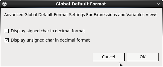

    However, I did find that CCS allows the default format for unsigned char variables to be set to decimal. If you use the View menu in the Expression view (the white triangle) and use Number Format -> Default Number Format... and on the dialog tick the "Display unsigned char in decimal format" option this may prevent the issue:
