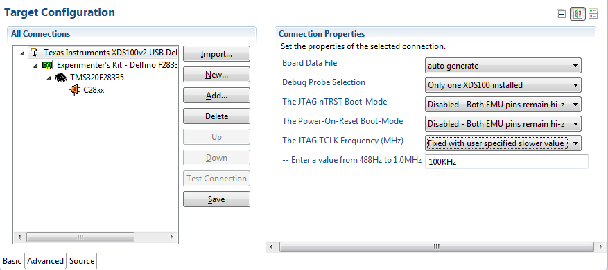

    Given the JTAG debugger you are using is very reliable and it already runs at a relatively slow frequency of 1MHz on JTAG TCLK, this parameter shouldn't require tweaking. If you want to tweak this, then check the settings as shown below:
