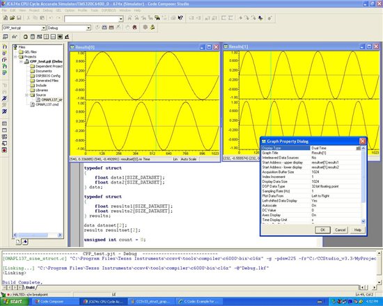

    I managed to display arrays of structs (which contain arrays as its members) in graphs in CCSv3.3, but I had to use the literal variable names with the array indexes - I could not use an indexer for each member of the array of structs.
    Just FYI, I send the project I used attached and a screenshot is shown at the end of this post. I am using everything static and global, since the graph tool may be confused if a local variable is used (especially because the compiler can potentially store it in a register).
     Hope this helps,
    Rafael

  • Matt,
    Just clarifying: when you enter Start Address: statArray.data1 and Index Increment: n you get displayed statArray[0].data1 thru statArray[4095].data1, is that so?
    You want to enter Start Address: statArray[0].data2  to display statArray[0].data2 thru statArray[4095].data2, right?
    I am just checking, since I managed to display the interleaved graphs using Start Address: &results[0].resultset1, &results[0].resultset2 and so on. (check the attached project and the graph below).
    Hope this helps,
    Rafael
