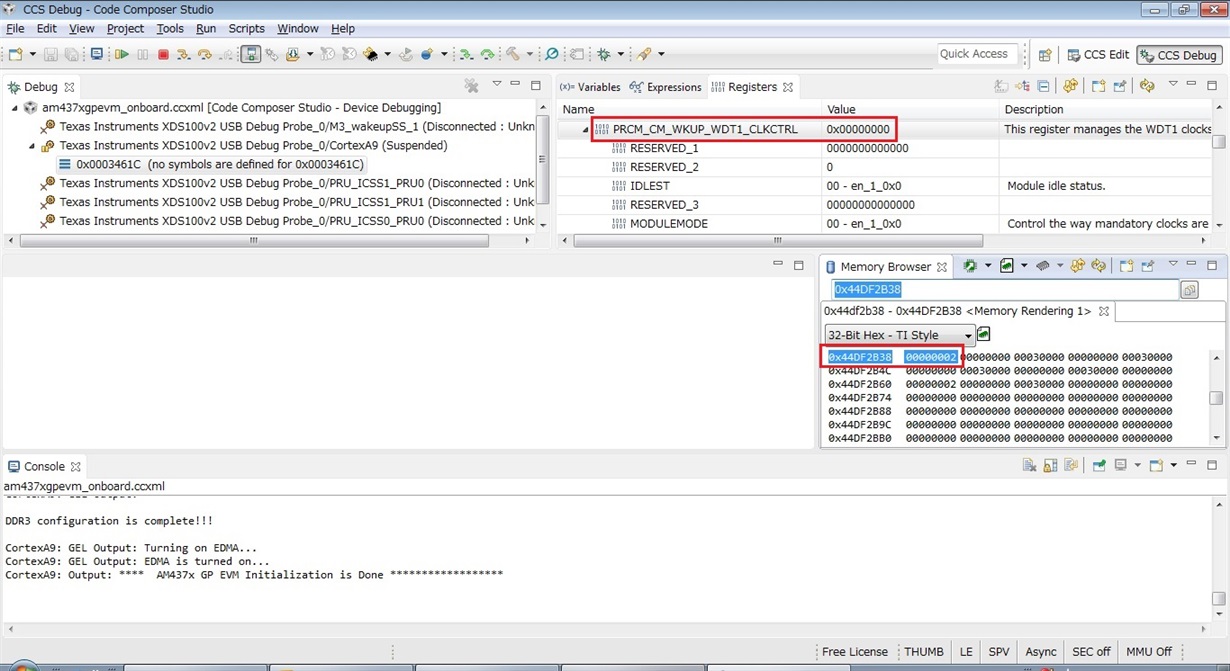

I'm working with AM437x GP EVM and CCS v6.1.3.
After connecting the Cortex-A9 core I tried to read/write a PRCM_CM_WKUP_WDT1_CLKCTRL register in Registers View, but I couldn't
I could read/write it in Memory Browser View.
So, could you please let me know how to read/write it in Registers View?  Is there anything what I should setup?
    From your screen shot the memory browser shows the value 0x2 at address 0x44df2b38. Whereas the register view is showing the PRCM_CM_WKUP_WDT1_CLKCTRL register as having the different value of 0x0. i.e. there is a discrepancy between the memory browser and register view.
    From the AM437x TRM the address of the PRCM_CM_WKUP_WDT1_CLKCTRL is 0x44df2b38.
    On looking at a CCS 6.1.3.00033 installation eith Sitara Device Support 1.2.9 the AM437x device files have incorrectly defined the base address of the CM_WKUP module registers as 0x44df2000 rather than 0x44df2800. i.e. the following files:
    • ccsv6\ccs_base\common\targetdb\devices\AM4376.xml
    • ccsv6\ccs_base\common\targetdb\devices\AM4377.xml
    • ccsv6\ccs_base\common\targetdb\devices\AM4378.xml
    • ccsv6\ccs_base\common\targetdb\devices\AM4379.xml
    Contain the following entry for the CM_WKUP module:
    <instance href = "../Modules/am437x/CM_WKUP.xml" id = "CM_WKUP" xml = "CM_WKUP.xml" xmlpath = "../Modules/am437x/" baseaddr = "0x44df2000" size = "0x2000" accessnumbytes = "1" permissions = "rw" description = "" />
    Which should be:
    <instance href = "../Modules/am437x/CM_WKUP.xml" id = "CM_WKUP" xml = "CM_WKUP.xml" xmlpath = "../Modules/am437x/" baseaddr = "0x44df2800" size = "0x1800" accessnumbytes = "1" permissions = "rw" description = "" />
    After making this correction in a CCS 6.1.3 installation, and restarting CCS, I was then able to use the register view to change the value of the PRCM_CM_WKUP_WDT1_CLKCTRL register in an AM4378.
    Edit: Also correct the size of the CM_WKUP module.
  • Hi Chester,
    I appreciate your support.
    I modified AM4378.xml and then I can read/write the register in Registers View now. I hope the xml files would be revised soon.

  • Chester, j-breeze,
    Thanks for reporting this; I filed the bug SDOAPPSCOL-13 today and already fixed this issue.
    This will be available in releases 1.3.0 of the Sitara Device Support (its release date is still TBD).
    I apologize for the inconvenience,
