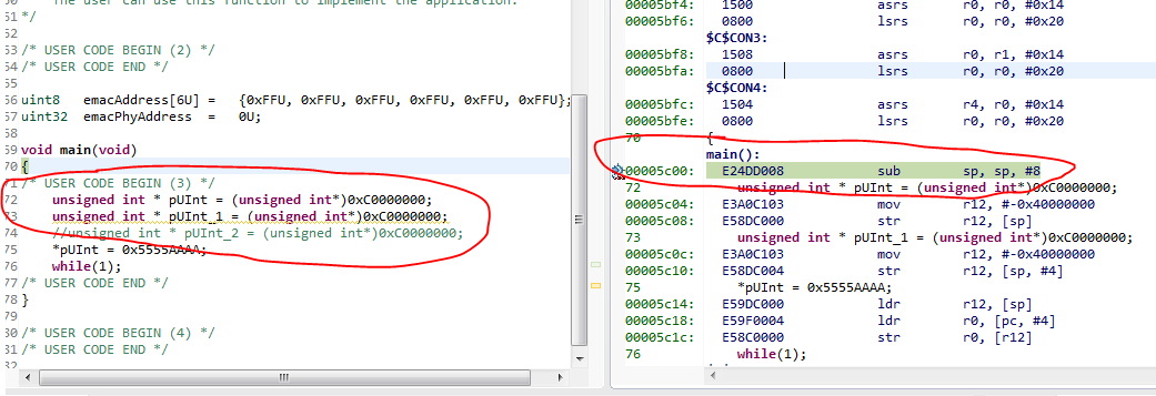

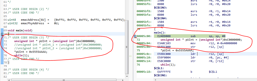

When I use one pointer variable, the space is reserved by "sub sp, sp, #8" but in my opinion, it should be "sub sp, sp, #4"
When I use two pointer variables, the space is reserved by "sub sp, sp, #8" same as the first one.

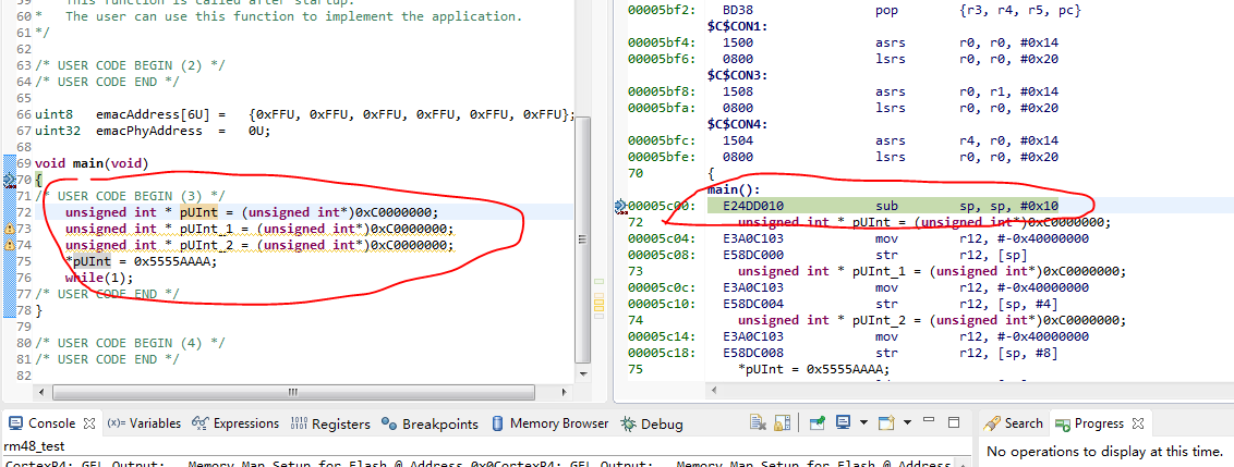

When I use three pointer variables, the space is reserved by "sub sp, sp, #0x10".

Yes, if you are using EABI. Section 6.10.2 Run-Time Stack of the ARM Optimizing C/C++ Compiler v5.2 User's Guide says:eric said:can I infer that the compiler will keep the stack's alignment to 8 bytes, right?
EABI requires that 64-bit data (type long long and long double) be aligned at 64-bits. This requires that the stack be aligned at a 64-bit boundary at function entry so that local 64-bit variables are allocated in the stack with correct alignment. The boot routine aligns the stack at a 64-bit boundary.
