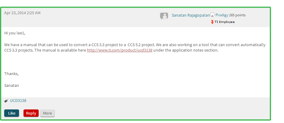

The first reply in https://e2e.ti.com/support/power_management/digital_power/f/184/t/357163#pi239031350=1 has a link to TI Fusion Digital Power Designer which has a utility for converting CCS 3.3 to CCS 5.2 projects for UCD31XX devices.johnliang said:I have some problems,the link
http://www.ti.com/litv/zip/sluc456 is invalid
I think the TI Fusion Digital Power Designer "Isolated CCS Conversion Tool" has replaced the previous conversion template in the now dead www.ti.com/.../sluc456 link. Suggest you ask on the Digital Power Forum

Dear Chester Gillon,
I don't know the rules, sorry. Thank you for your letter, and i have the last one quesion. With reference to your instructions, i find relevant informationI in the digital power forum. What's the tool that can convert automatically said by Sanatan Rajagopalan, NOBODY REVIEW ME, could you tell me if convenient. Thanks,
