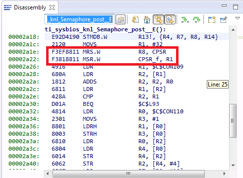

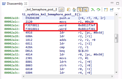

When using CCS 6.1.3.00033 to check when interrupts were disabled / restored in SYS/BIOS for a Cortex-M4F (TM4C1294NCPDT) noticed that the CCS disassembly view was showing the raw .word value for some instructions rather than the actual instruction:
          ti_sysbios_knl_Semaphore_post__E():
00002a10:   E92D4190            push.w     {r4, r7, r8, lr}
324           hwiKey = Hwi_disable();
00002a14:   2120                movs       r1, #0x20
00002a16:   F3EF8811           .word       0x8811f3ef
00002a1a:   F3818811           .word       0x8811f381
00002a1e:   4916                ldr        r1, [pc, #0x58]
00002a20:   680A                ldr        r2, [r1]
00002a22:   1812                adds       r2, r2, r0
00002a24:   6811                ldr        r1, [r2]
00002a26:   428A                cmp        r2, r1
00002a28:   D01A                beq        $C$L93
00002a2a:   4814                ldr        r0, [pc, #0x50]
 300          Task_module->locked = TRUE;
00002a2c:   2301                movs       r3, #1
 298          UInt key = Task_module->locked;
00002a2e:   8801                ldrh       r1, [r0]
00002a30:   8003                strh       r3, [r0]
 59           elem = obj->elem.next;
00002a32:   6810                ldr        r0, [r2]
 60           next = elem->next;
00002a34:   6804                ldr        r4, [r0]
 61           obj->elem.next = next;
00002a36:   6014                str        r4, [r2]
 62           next->prev = &(obj->elem);
00002a38:   6062                str        r2, [r4, #4]
353           if (BIOS_clockEnabled && (elem->tpElem.clock != NULL)) {
00002a3a:   68C7                ldr        r7, [r0, #0xc]
 301          return (key);
00002a3c:   460C                mov        r4, r1
350           elem->pendState = Semaphore_PendState_POSTED;
00002a3e:   7403                strb       r3, [r0, #0x10]
00002a40:   B10F                cbz        r7, #0x2a46
678           obj->active = FALSE;
00002a42:   2100                movs       r1, #0
00002a44:   82B9                strh       r1, [r7, #0x14]
358           Task_unblockI(elem->tpElem.task, hwiKey);
          $C$L92:
00002a46:   6880                ldr        r0, [r0, #8]
00002a48:   4641                mov        r1, r8
00002a4a:   F001F9F9            bl         #0x3e40
360           Hwi_restore(hwiKey);
00002a4e:   F3888811           .word       0x8811f388
362           Task_restore(tskKey);
00002a52:   4620                mov        r0, r4
00002a54:   F001FA68            bl         #0x3f28
00002a58:   E8BD8190            pop.w      {r4, r7, r8, pc}
00002a5c:   EA4F0808            mov.w      r8, r8
327               if (((UInt)sem->mode & 0x1) != 0) {   /* if BINARY bit is set */
          $C$L93:
00002a60:   7A01                ldrb       r1, [r0, #8]
00002a62:   0849                lsrs       r1, r1, #1
00002a64:   BF3A                itte       lo
331                   sem->count++;
00002a66:   8941                ldrh       r1, [r0, #0xa]
00002a68:   1C49                adds       r1, r1, #1
328                   sem->count = 1;
00002a6a:   2101                movs       r1, #1
00002a6c:   8141                strh       r1, [r0, #0xa]
335               Hwi_restore(hwiKey);
00002a6e:   F3888811           .word       0x8811f388
00002a72:   E8BD8190            pop.w      {r4, r7, r8, pc}
00002a76:   46C0                mov        r8, r8
          $C$CON109:
00002a78:   674C                str        r4, [r1, #0x74]
00002a7a:   0000                movs       r0, r0
          $C$CON110:
00002a7c:   15F8                asrs       r0, r7, #0x17
00002a7e:   2000                movs       r0, #0
Changing the Disassembly Style from "Mixed ARM/Thumb" to "Thumb Only" didn't correct the disassembly (the Cortex-M4F only supports Thumb mode instructions).
The armdis program from TI ARM compiler v_15.12.1.LTS can disassemble all the instructions, which shows that the instructions CCS failed to disassemble manipulate the BASEPRI register:
