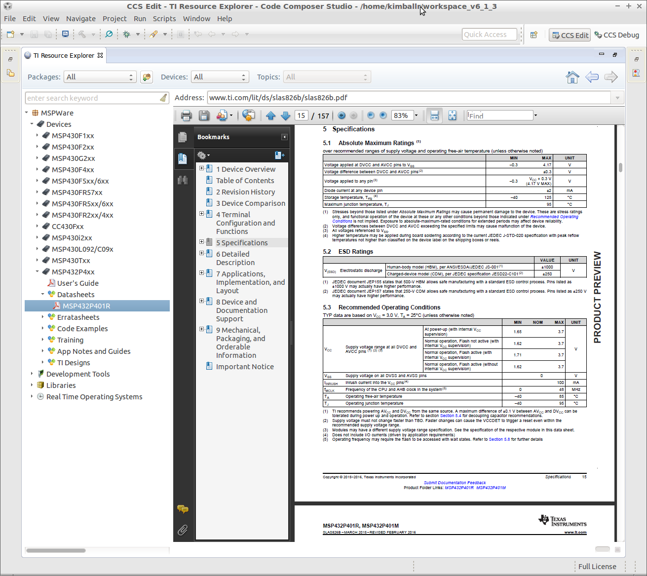

  • I was really trying to figure out why the pdf files are not opening in the browser window of CCS. Instead of displaying them, it asks if I want to save them.

  • I did have Adobe Reader 9 installed that had an nppdf.so file. I uninstalled it. Still the same behavior. When I click on the links in the Resource browser that are .pdf files it prompts me to save the file instead of viewing it. I'm going to wait for CCS 6.2 to see what changes that brings. It is supposed to fix PDF viewing problem.

  • So after spending an inordinate amount of time using the strace utility to figure out the missing parts I was able to make it work.  Hopefully when the CCS 6.2 version comes out there will be a better solution than what is being done now:
    I have been spending a great deal of my day trying to get this to work as well (installed Adobe reader, changed browsers, added mime types, included the nppdf.so, collapsed chromium/CCS a few times, etc.) but to no avail.
    With the risk of being seen as wanting to be "spoon-fed" but with the true intention of helping others in the future, would you mind sharing the solution you found?
