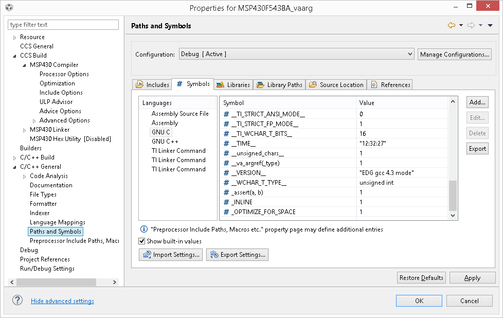

    Looking in the CCS Project Properties -> C/C++ General -> Paths and Symbols under symbols shows a built-in value for a definition of __va_argref :
    If you compare the built-in symbols for CCS 6.1.1 and 6.1.3 are there any differences?
    [To see the C/C++ general properties you have to select the "Show advanced settings" in the bottom left of the CCS project properties dialogue]

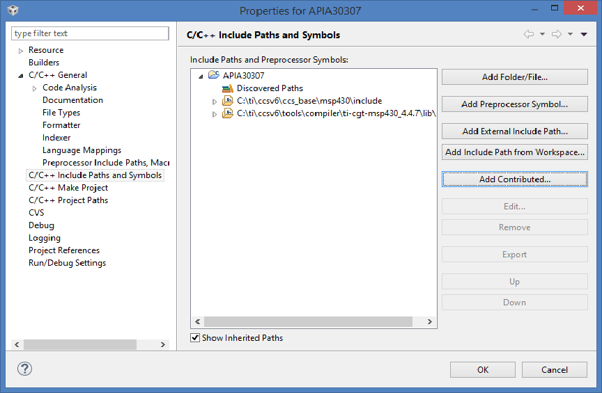

    I think the problem is that my project is not a managed project by CCS but a makefile project and as such the symbols are not included.
    The code I am having an issue with is building a library of our own functions for use with a range of PCBs and processors.
    As such, my makefile builds a number of variants of the code and includes the appropriate processor headers depending upon the defines used for the build.
    See my project properties below:
