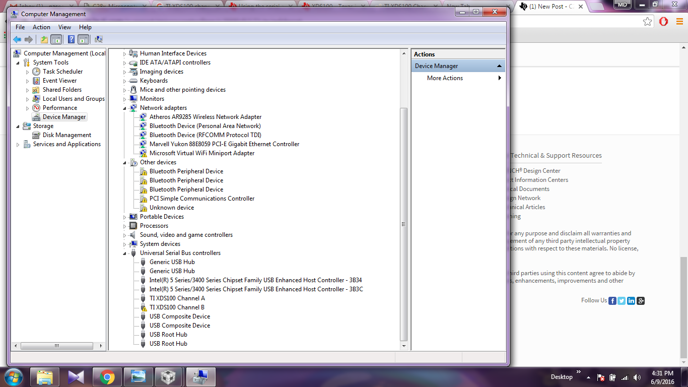

Dear sir,
I have installed cc6 version properly but when i connect my kit,c2000 tms320f28027,it was showing device drivers not installed properly.....i checked in device manager,there it was showing channel A but for channel B it was showing exclamatory symbol(! ,means drivers not installed).
when i update my drivers by browsing to c\ti,it was showing drivers are up to date.but the exclamatory mark dint gone.what is the problem....
can i download channel B driver  externally,if so please send me the link.

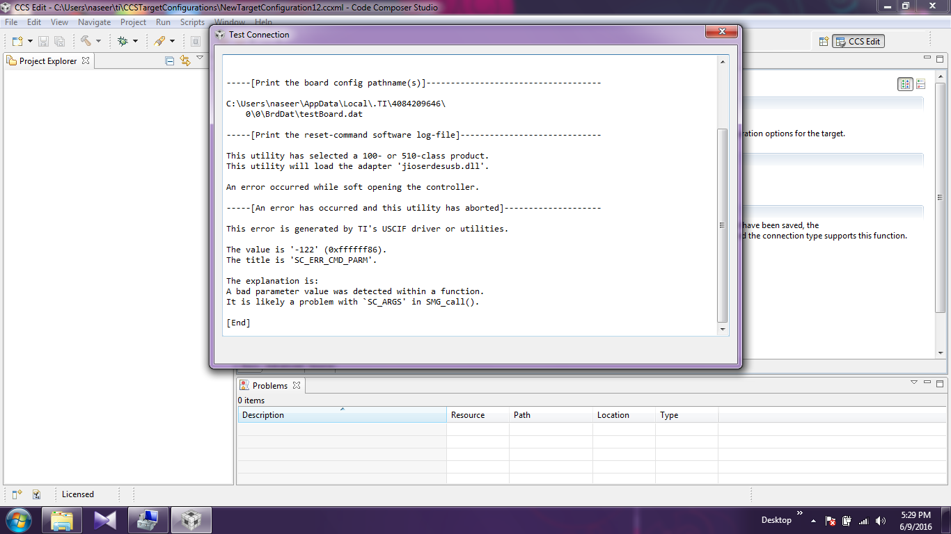

    when i have done "test connection" in ccs,it was showing like this.please see the attachment.please help to sort it out.
    thank you

  • Try uninstalling the device from Device Manager -> Then do a Scan for Hardware Changes. If that doesn't help you try installing CCS again and don't forget to install Spectrum digital emulator drivers.
