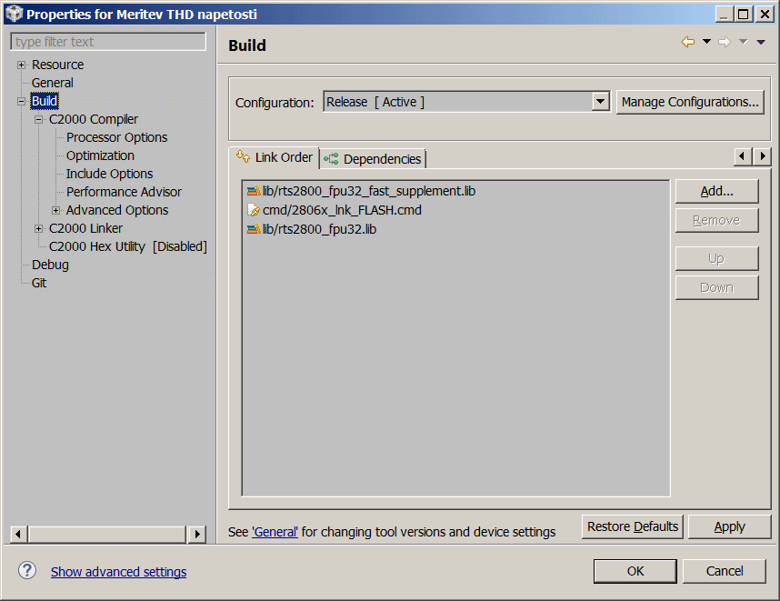

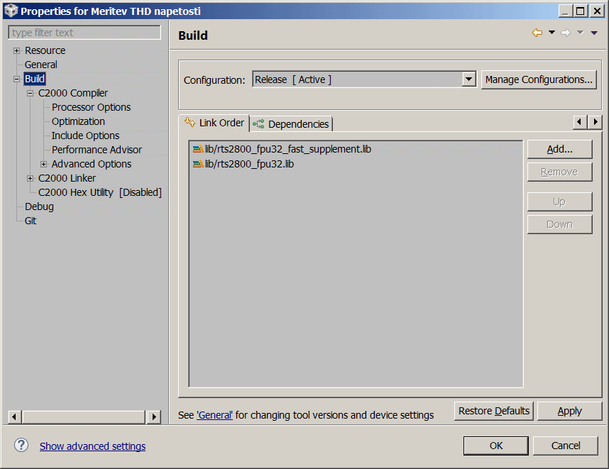

    Hi George,
    I've attached linker .cmd file. Linker is invoked with folowing swithces (copy/pasted form CCS:
    -v28 -mt -ml --vcu_support=vcu0 --cla_support=cla0 --float_support=fpu32 --fp_mode=relaxed --advice:performance=all -g --diag_wrap=off --display_error_number --issue_remarks --verbose_diagnostics --gen_func_subsections=on --c_src_interlist -z -m"Meritev THD napetosti.map" --stack_size=0x300 --warn_sections -i"C:/ti/ccsv6/tools/compiler/ti-cgt-c2000_6.4.6/lib" -i"C:/ti/ccsv6/tools/compiler/ti-cgt-c2000_6.4.6/include" --reread_libs --disable_auto_rts --verbose_diagnostics --diag_wrap=off --display_error_number --issue_remarks --xml_link_info="Meritev THD napetosti_linkInfo.xml" --rom_model
    Linking order was set within CCS project settings (BTW why is this not the part of linker settings?)
    If I add also the .cmd file in the linking order setinhs like this I don't have any issues:
    But if I place tha .cmd file at the top of the linking order I get following errors:
    "../cmd/2806x_lnk_FLASH.cmd", line 72: error #10008-D: cannot find file "rts2800_fpu32_fast_supplement.lib"
    rts2800_fpu32_fast_supplement.lib<atan2_f32.obj>(.text)
    I thought I understand the linking process, but I clearly need some tutoring. So my questions are:
    1. Why do I have this issue, what is causing it?
    2. Why the solution works?
    3. Why do I get linking error when .cmd file is the first to link?
    Thank you for your support

  • Hi George,
    I understand the principle behind it. I don't have clear picture who or what sets the linking order within CCS?
    From reading C2000 assembly tools manual i think it is the order of "--library=..." options. I assume this is the reason why does the CCS have the option to move up/down the specified libraries under linker options. But why does the CCS also have the linking order tab under the build options? I'd imagine because you can also specify the order for processing .cmd files and other files. But which of these two ways takes effect when CCS is building the command line call to the linker? What if you specify the order under the build options, but you don't include the libraries under linker options? Shouldn't the tab be moved under linker options?
    It seems that my main beef is with CCS and not really with CGT.
    Thanks for the help.

  • I agree with George that the issue in this thread is not related to the CCS 6.1.3 problem, and is only related to the linker and the order in which files are processed by the linker.
    In CCS, there are two areas where ordering comes into play. If files are directly added/linked to the CCS project (these can be libraries, .cmd files etc), they appear on the command line just like all the object files and it is their ordering that can be controlled via the "Link Order" tab.
    Alternately, they can be added to the --library option under Linker File Search Path, and the ordering there can be controlled via the Up/Down arrows. These are just two different ways of passing files to the linker.
    In this particular use-case, if you place the .cmd file at the top of the linking order, it is encountered first, and that at point, it does not yet know where to locate rts2800_fpu32_fast_supplement.lib that is referenced in the .cmd file. In this case, if you add the library path ${PROJECT_ROOT}/lib to the --search_path option, that will also get rid of the linker error.
