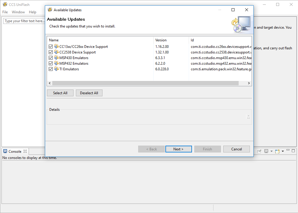

    The screen shot from Uniflash shows that Uniflash is using "Emulation package 6.0.83.1", which is different the version 6.0.228.0 of the Emulation package used by CCS.
    I believe that the XDS110 firmware is in the Emulation package, and so by switching between CCS and Uniflash with different versions of the Emulation package will trigger the XDS110 firmware to be changed.
    In your Uniflash installation try using Help -> Check for Updates and see if there is an Emulation package update available. Updating Uniflash to the same version of the Emulation package should avoid the need for the XDS110 firmware to be changed when switching between CCS and Uniflash.

  • You are right;
    Current version in UniFlash
      TI Emulators 6.0.83.1 com.ti.emulation.pack.win32.feature.group Texas Instruments
    When I press check for updates:
    Installing now. I'll report back.
  • Confirmed that updating the UniFlash emulator tools fixed the issue.
    Both UniFlash and CCS are now on the same version, and neither of them asks for the firmware update anymore.
    Thank you!
