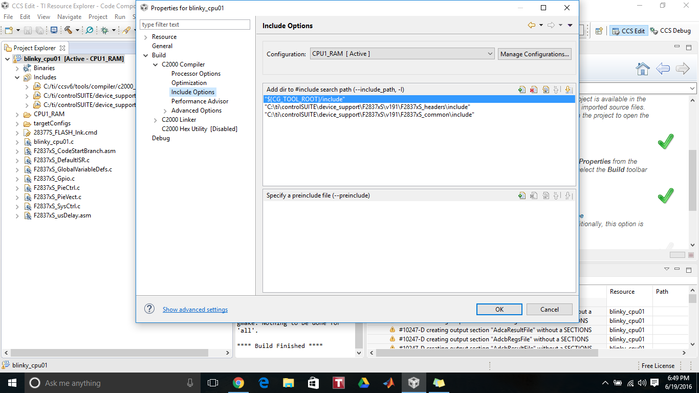

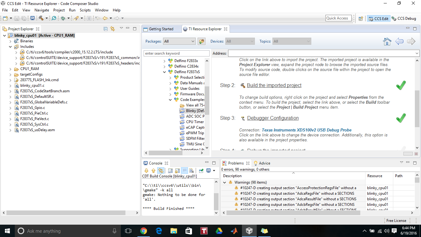

I have purchased, i was trying to run the blink LED program, but couldn't. I got 98 warning and  not able to debug the project and program not able to flash in to the evaluation board. i have attached screen sot for your reference.
    According to your screenshots, the project was built successfully. You did have a bunch of warnings, but that doesn't necessarily mean a build failure. What happens where your press the link for Step 4?

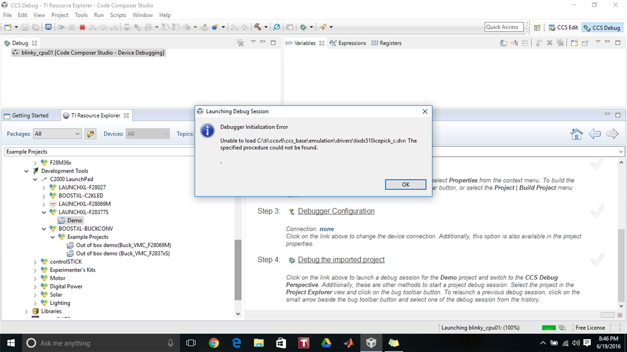

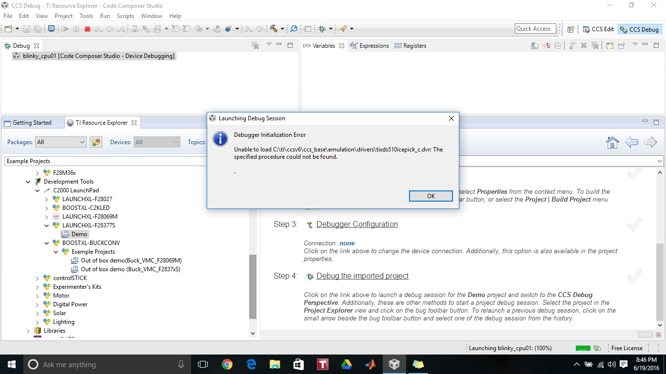

  • Hello All,
    I followed the blink led steps as per example code. After successful build, i got 98 warnings (10247D and When I press debugger link, it shows that debugger initialization error. I have attached error screenshot FYI.
    As per the screenshot I checked the driver file in corresponding folder, all files are available. Please help me to resolve.

  • This is odd. Your first screenshot showed your project configured for an XDS100v2 (Step 3). In your last screenshot, it is referencing an XDS510. How did you launch the debug session in your last screenshot?
