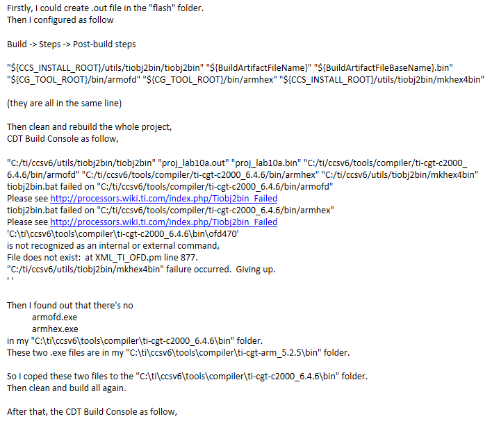

I want to generate .bin file from CCS version6.1.2.
I have already configured the build - post-build steps in the right way.

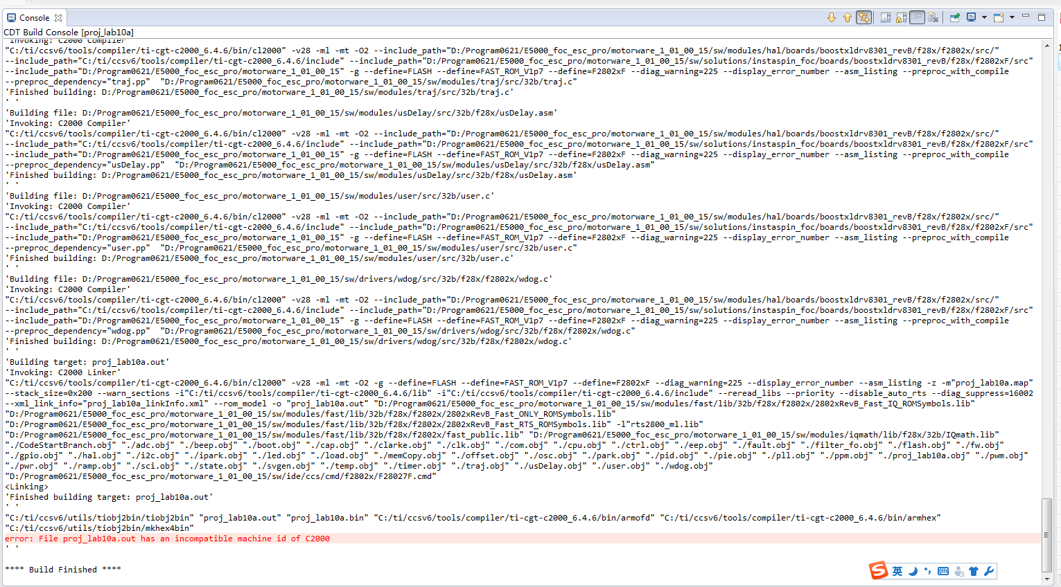

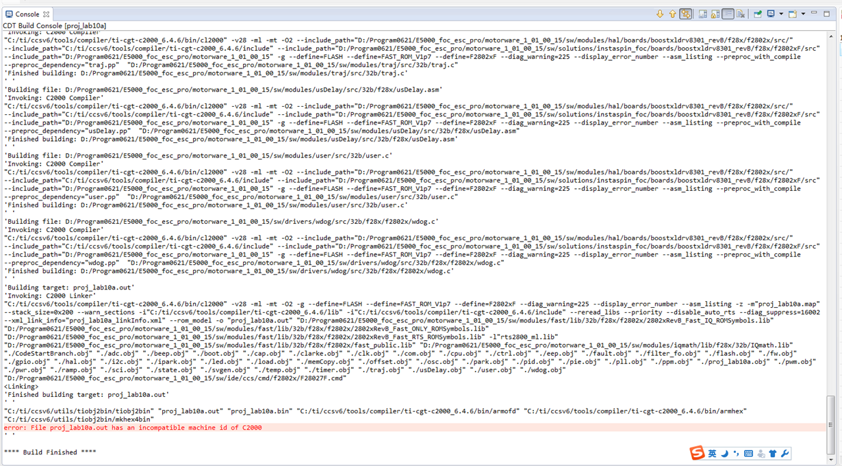

Then I clean and build the project, then the console as follow:
error: File proj_lab10a.out has an incompatible machine id of C2000.
what's the problem? how could i fix it?
Thanks.

  • Let me describe my detail step again.
    I'm so sorry that due to my company's IT restriction, I could only use the "print scree" to provide the information.
    Looking forward to your feedback.
    Thanks.
    Claire.Zhang
  • Since you are using a f28020x device, in the post build step try changing from using armofd and armhex to ofd2000 and hex2000.
    From the build output it looks like the armofd program, which expects an .out file from from an ARM family device, reports an error when given a .out file from a  C2000 family device.
  • I confirm that the solution given by Chester Gillon is mostly correct.  The utility armofd does not complain when it sees object files for CPU families other than ARM.  But armhex does.  And tiobj2bin.bat uses both of them.  At any rate, changing over to ofd2000 and hex2000 is the correct solution.

  • I changed the post build step to ofd2000 and hex2000, then it really worked.
    It can generate *.bin file now.
    Thanks very much.
