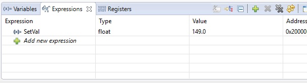

So this is a strange one but when debugging a tiva c launchpad I was having a strange issue with a variable seeming to go negative.  When I started thoroughly testing it I noticed a strange phenomenon.  I'm watching a variable in the expression window which does not change during the entire execution.  However as soon as I move to another window say registers or variables, when I switch back the variable has suddenly become a very large negative number.
This is the view before changing:
This is what happens after I switch to Registers and back again:
    Is the program halted or still executing when you switch to the registers view and back to expressions view? If it is halted I would not expect the value to change, but if it is executing then the value will be updated when you switch back to the view.
    Are you able to share a simple example project that demonstrates the issue?
