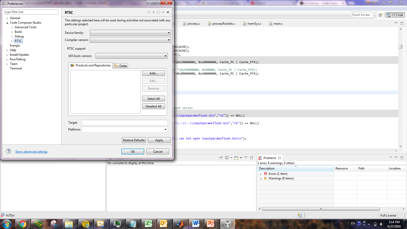

I cannot load RTSC into CCS6. It does not even find all the library installed under c:\ti folder. How to handle this issue?

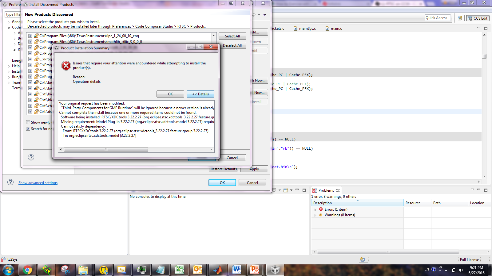

  • I have both CCS5 and CCS 6 on my PC. I have a project created in CCS5 that uses several library. After I install CCS6, the first time I launch CCS6, it automatically detect a list of available products/repositories, so I was trying to load all the products, but end up with some error. I don't remember the error. I thought I could repeat it by re-run CCS6. But it did not pop up the window to install products/repositories. Now if I check Window->Preference->RTSC page, I don't see any repository available. If I open the same project created in CCS5, all the RTSC are missing in CCS6. I have attached the image for your reference

  • It did find the products after add the path c:\ti\ccs6, then I select all the products. After a few seconds, I get this error. This is the same error I saw before, as attached image
  • It looks like it is failing to install XDC 3.22.2.27. Can you uncheck that package and try to install the rest?
