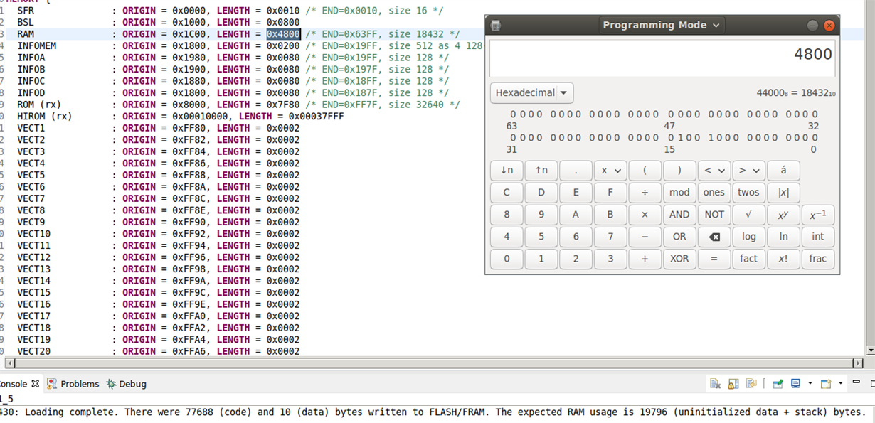

When flashing the uC, the CCS tells me that the expected RAM usage is 19796 bytes, but the default linker script and the specification data sheet for the msp430F5335 indicates that I only have 18432 bytes.  Why would CCS allow me to flash the system if there is not enough memory?  See below.
I am use CCS 6.1.3 on Linux.

    Thanks, but yes, this is totally throwing me off, looking at the ram of the map file

    It is telling me that ther is 0x22e4 unused bytes, that's 8.9K of unused memory, so which one is true?  What do I go by?
    The message "MSP430: Loading complete." about the expected RAM usage reported in the CCS console is incorrect - see CCS Shows way to much expected ram usage in console window after build
    The work-around is look at the RAM usage in the linker map file, or using the CCS Memory Allocation view.

    Checking the status of SDSCM00052390 in the Bug Tracking system shows the defect has a Severity of "Minor" and a Target Release of CCS 6.3.0. Given that CCS 6.2.0 hasn't been released yet, probably several months before SDSCM00052390 is fixed.
    Since the actual MSP430 memory usage is available in the linker MAP file or the CCS Memory Allocation view, to avoid confusion until the proper fix for SDSCM00052390 can the confusing "expected RAM usage" be removed from the  "MSP430: Loading complete" message displayed when starting a debug session?
