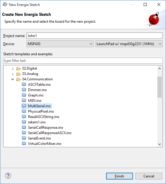

    Here are my Energia settings

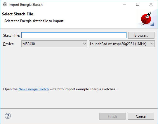

    If I go to the project menu and select New Energia Sketch this is what I see:
    If I select to import a sketch from the project menu this is what I see:
    A couple things I would try:
    Try creating a new workspace.  I am wondering if something has gotten corrupted in the workspace.  If creating a new workspace allows you to use Energia then we know that is the problem and can try to clean the old one.
    You can add -clean to the ccstudio.exe command line.  Or run from a command prompt.  ccstudio.exe -clean
    I am checking around to see if anyone has seen anything like this.
    John
