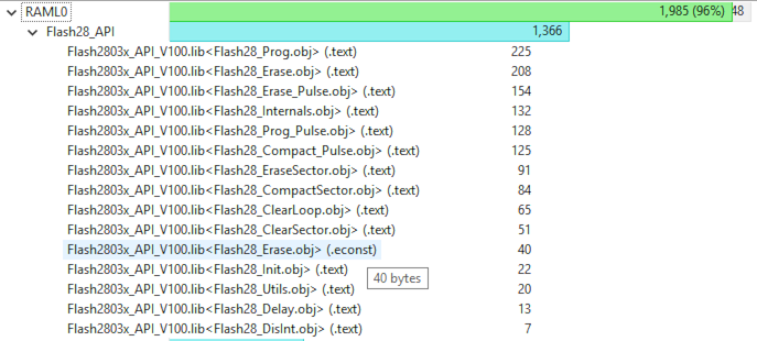

So, say you have a simple F280xx project and in a cmd file, you are trying to specify a section for the FlashAPI lib.  This is what's in the Flash API example cmd files in controlSuite.
    Flash28_API             : {
                            -lFlash2803x_API_V100.lib(.econst)
                            -lFlash2803x_API_V100.lib(.text)
                          LOAD = FLASH_A_H,
                          RUN = RAML0,
                          LOAD_START(_Flash28_API_LoadStart),
                          LOAD_SIZE(_Flash28_API_LoadSize),
                          RUN_START(_Flash28_API_RunStart),
                          PAGE = 0
When I look at the memory allocation, I notice there is no .econst section of Flash28_Erase.obj, even though I told it to include .econst.
Now, if I don't specify .econst or .text in the -l option and compile again with no other code changes, suddenly I get the .econst section of Flash28_Erase.obj, which adds another 40 bytes (which is weird because 1325 + 40 != 1366 as shown below).

Have tried with both CGT 6.4.x or 15.2.x
  • I realize that after looking at the .map file, the .econst is actually in there in both cases, so it's just CCS for some reason doesn't display it correctly.
    The one extra hole is peculiar though.  This is the map of when I reference only -lFlash2803x_API_V100.lib

                      003e91ef    00000001     --HOLE-- [fill = 0]
                      003e91f0    00000028                             : Flash28_Erase.obj (.econst)

    and when I reference -lFlash2803x_API_V100.lib(.econst) and -lFlash2803x_API_V100.lib(.text)
    Flash28_API
    *          0    003e8d00    00000555     RUN ADDR = 00008000
                      003e8d00    00000028     Flash2803x_API_V100.lib : Flash28_Erase.obj (.econst)

  • That hole is alignment padding.
