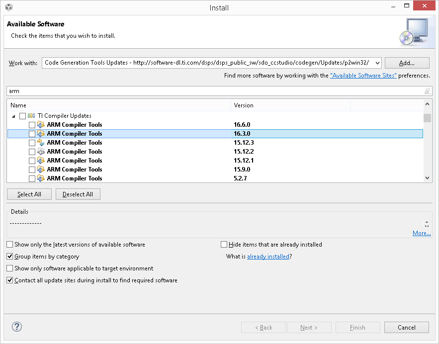

So I am trying to debug a project submitted on E2E as a CCS project zip file.

When I go to the install new software tool in CCS though I only see 16.6.0.
I installed 16.6.0 and my 'Installation History' shows compilers 16.6.0 and 15.12.3 as installed.
How do I get 16.3.0 STS or otherwise work around this import failure?
    Did you untick the "Show only the latest versions of available software" option on the Install New Software dialogue?
    By untiicking "Show only the latest versions of available software" CCS 6.1.3 is showing 16.3.0 as available to install:
  • Chester Thanks!
    Brain-dead on my part.  I had unchecked the 'Hide items that are already installed' but forgot 'Show only the latest versions...'
