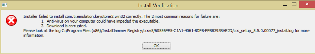

I have installed CCS v6 on my laptop and it worked. but I have to change it to CCS v5.5 because I have the C6713 DSP kit that I want to use.
The problem is with installation of CCS v5.5. I tried all the solutions written and answered in the forum:
* I made offline installtion, and put the setup program in a short path directory that has no spaces in between.
* I removed the CCS v6 from the windows' control panel and all TI's sub-programs and also deleted the 'InstallJammer regustry' folder and then tried again.
* I tried installing the program in a different name that the program suggests 'ti_2' instead of 'ti'.
* I ran the program in 'windows 7 compatiblity mode', and 'run as an administrator'.
But those trials are not enough yet to install the program :)
I have attached screenshots of the two errors and a copy of the last created 'InstallJammer registry' folder.
Also tell me please if it will be better to install an older version of CCS.
Thanks in advance,
Muhammad Foad Abohegab
The first error:
And the second error:
and this is the a copy of the last created 'InstallJammer Registry' folder:
3716.InstallJammer Registry.zip
  • It looks like the keystone 2 component failed to install. Unfortunately, the error message isn't very helpful. I would recommend installing (after deleting the previous installation completely) by unchecking the keystone 2 component. If you need keystone 2, we can install it separately on the command line. I can help you with that.
