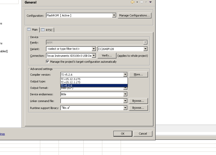

Hy there,

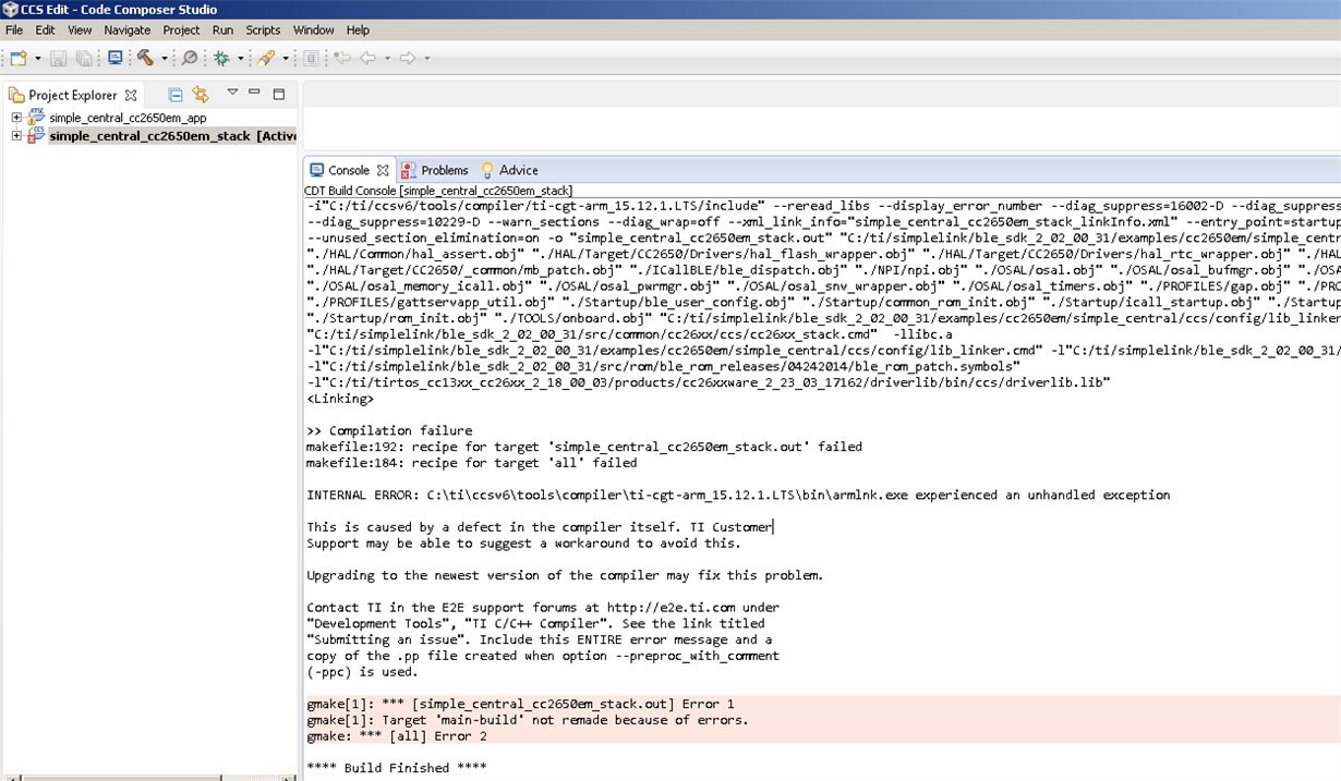

kind of a strange thing: Tried to switch to BLE Stack 2.2 on a new PC (it is not possible to have 2.1 and 2.2 on the same PC, right)
I also installed TI ARM Compiler Tools 5.2.6 as described, it shows in my installation details
But in project settings, I can't select the 5.2.6 compiler
Also, I can't see the compiler in compiler folder in c:\ti\ccsv6\tools\compiler
When I try to build stack or app I get build errors.
What am I doing wrong?

    Can you run the SW update in CCS to get 5.2.7 or 15.12.3.LTS compiler updates? The latter fixes the error that you show in the build log.

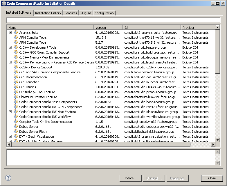

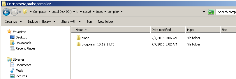

  • Hi JXS,
    I have the same problem as Harald.
    * I installed the ARM Compiler Tools 15.2.3 installed in the  CCS Instalation Details but I only have the choice for TI v15.12.1.LTS toolchain in the Build Properties.
    * I installed the ARM Compiler Tools 5.2.6 in the  CCS Instalation Details but I only have the choice for TI v5.2.5 toolchain in the Build Properties.
    In the tools/compiler/ directory of the CCS installation path there is only the toolchain installed at CCS installation time.
    My CCS is Version: 6.1.3.00034
    Best Regards
    Jérôme

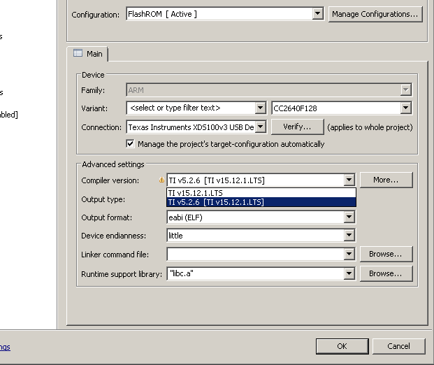

  • Harald - You can have multiple BLE-Stack SDK installations. The default path is C:\ti\simplelink\ble_sdk_version_xx (as specified in release notes). You can un-install with the uninstaller from windows control panel or via the start menu link.
    Can both of you use the "More" button to force the compiler to v5.2.6+? It seems that it's auto-selecting v15.12.1 over v5.2.6. The More button should allow you to override the 15.12.1.LTS.
    Let me know if that works. Otherwise, I'll need to transfer this to the CCS team.
    Best wishes
  • In the more button there is the same choice: TI v15.12.1.LTS and TI v5.2.5. But TI v15.12.2.LTS+ TI v5.2.6+ are not available even tough installed.
    I think the installation of additional toolchain in CCS is buggy because there is no toolchain folder installed in the tools/compiler/ directory of the CCS installation path.
  • Hy, same for me: I can't select anything else on "more".

  • Hi JXS,
    I did as follow to reinstall CCS:
    * uninstalled CCS and all TI's related software (tools, BLE Stack, ..) with Windows's utility.
    * removed C:\ti folder
    * removed C:\Users\ME\AppData\Local\Texas Instrument ; C:\Users\ME\Workspace ; C:\Users\ME\ti ; C:\Users\ME\Texas Instrument)
    I couldn't find any key in Windows register keys.
    I reinstalled CCS (with all options) in another folder than C:\ti. Then I updated CCS at first start up
    and installed 5.2.7 toolchain. It does not solve the problem: I still have 15.2.3 and 5.2.7 toolchains
    appearing as installed but not available in C:\texas\ccsv6\tools\compiler\ directory nor in the selection in CCS Project's build configuration.
    Did I forget to remove something ?
    Jérôme O.

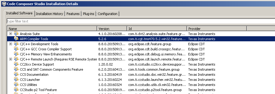

  • Hy,
    I did the same thing. I can't remember, if there were any leftovers in registry
    I installed it to c:\ti
    In my case, compiler 5.2.6 is available
    And it compiles alright using this compiler:
    'Building file: C:/ti/simplelink/ble_sdk_2_02_00_31/src/components/hal/src/common/hal_assert.c'
    'Invoking: ARM Compiler'
    "C:/ti/ccsv6/tools/compiler/ti-cgt-arm_5.2.6/bin/armcl" --cmd_file="C:/ti/simplelink/ble_sdk_2_02_00_31/exampl
    Strange thing is, that I can't see the 5.2.6 compiler in the installation details
    But the folder c:\ti\ccsv6\tools\ti-cgt-arm_5.2.6 exists
    So something is still strange. However I can compile, so I am happy.

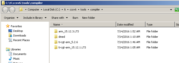

  • Hi danishinnis,
    Eventually I installed by hand TI ARM 15.12.3.LTS compiler from the install file downloaded by eclipse in ccsv6/eclipse/downloads. I launch the installation file with admin rights and told it to install the toolchain in the ccsv6/tools/compiler/arm_15.12.3.LTS directory. Then CCS/Ecplise is able to detect the toolchain. I can now build Project0 stack.
    Thanks for your help :)
    Jérôme
  • I suggest to install the toolchain with CCS in order to get the installer file in the ccsv6/eclipse/downloads/ directory and install it by hand in ccsv6/tools/compiler/arm_15.12.3.LTS if CCS failed to do it by itself (do not forget to launch installer with admin rights)
