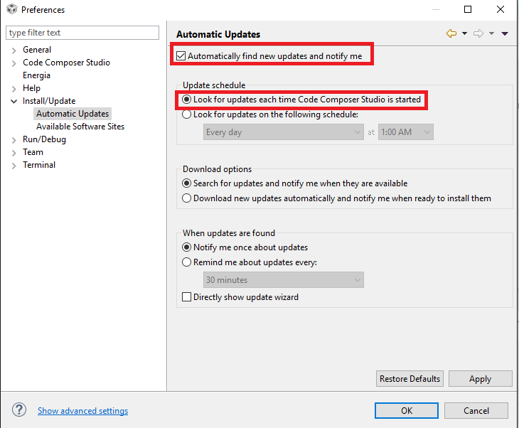

I am trying to develop code on a PC with WIN 10 for the CC1310. When I try doing something I eventually (not after too long) get to a point where my whole computer is bogged down. I cannot click on a file tab and have it switch until after 3 - 4 minutes! I cannot cancel CCS from the task manager - I end up getting "CCS is not responding, do you want to wait or cancel now" I cancel now and then I have to wait another minute or two before it finally shuts down.
My computer then works fine. It is an AMD A6-5200 at 2GHz with 12G RAM. I see this when running Task Manager and Webroot SecureAnywhere for system protection. It seems like there's a LOT of ethernet traffic when CCS starts up and when it tries to do most operations. BTW - build project seems to REALLY bring the system to its knees.
    By default, CCS will look for updates everytime you start up CCS. You can change this behavior by only checking at a specified time or even disabling auto-checking of updates completely.
    If I ever get a version of CCS that actually works (it used to be a lot more reliable), how can I freeze it and NOT let there be any changes to the toolset
    When you find a stable environment, you can decline to take any more updates. If you disable the auto-checking of updates as mentioned above, then you would not get any notification of updates.
