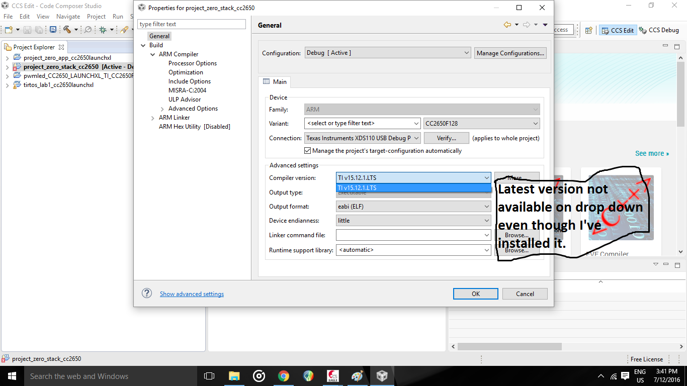

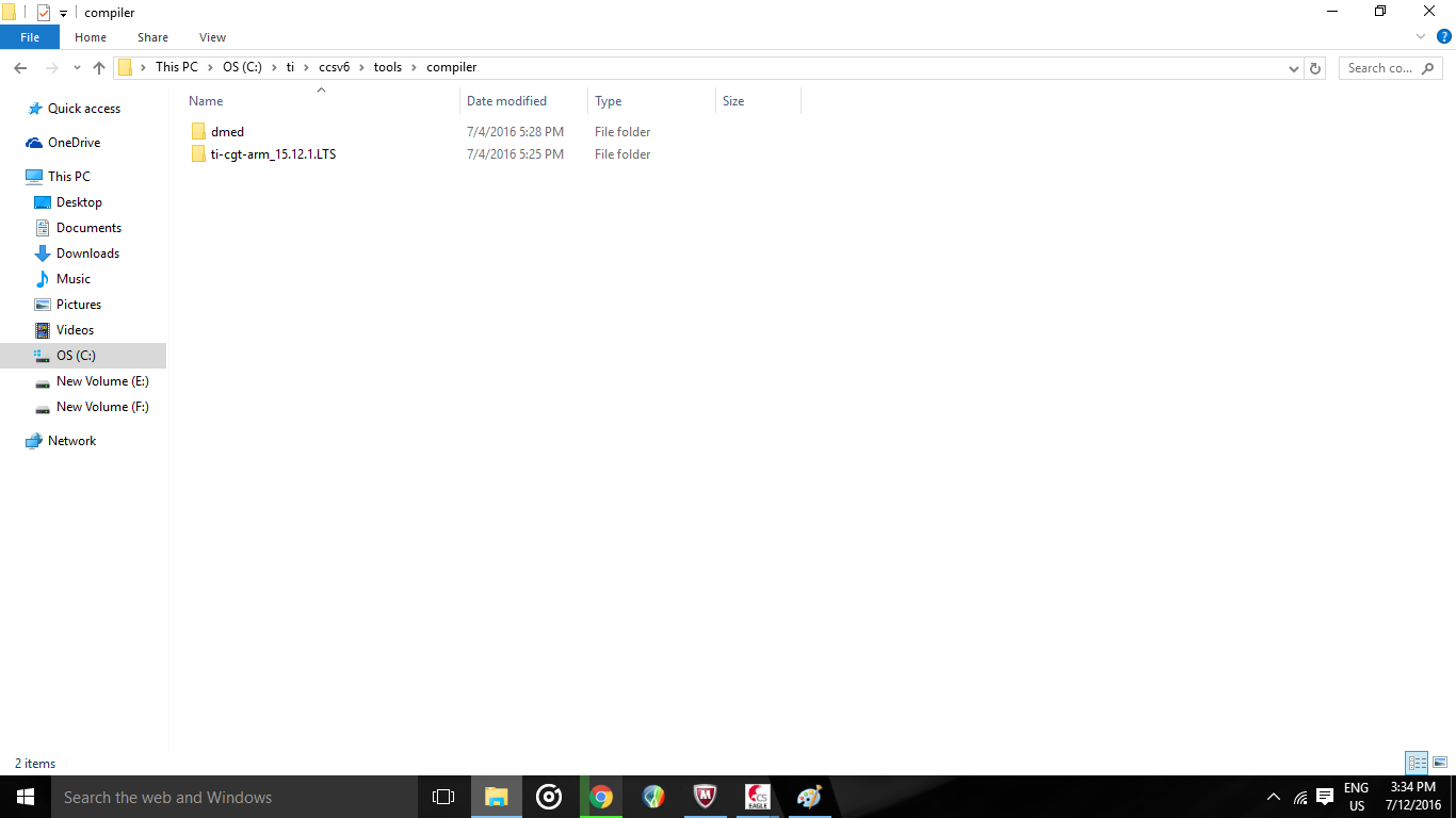

Recently, I installed the latest version of ARM compiler tools 15.12.3. However the latest version has not replaced the older version 15.12.1 and every time I check for updates, it says that everything is up to date. The softwares's latest version has also been updated in the installation details. However when I open "Show build Settings", the version displayed is the previous one, 15.12.1. Another puzzling fact is that when I browse my computer for the latest version, I do not find it's folder instead I find that the older version's folder is still intact. I have uninstalled the latest version and re-installed it too without any luck.  Any suggestions on tackling this issue?

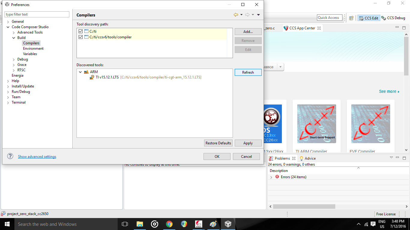

    Do you see the version 15.12.3 listed in the drop-down list for "Compiler version, and can you select it? Does it appear under Window Preferences->Code Composer Studio->Build->Compilers? Can you attach a screenshot of the discovered compilers on your installation?
    That is odd. The folder with the older compiler version should still be there but there should also be a new folder with the 15.12.3 compiler tools (under \ccsv6\tools\compiler). If there is no folder created for the 15.12.3 compiler tools, could you go to CCS menu Help->Installation History->Installed Software, select the 15.12.3 compiler and uninstall it, then install it again from the update site. Let us know if that helps.

  • Hi Dhruv,
    If you don't see the new compiler in the c:\ti\ccsv6\tools\compiler folder it won't show up in your compiler list. What version were you trying to install? I'll double check that it's available for update for your version of CCS.

  • Dhruva,
    Which version of CCS are you working with? There is another thread here with a similar issue. The user there was able to resolve the issue by uninstalling and reinstalling CCS (and other software packages they needed). Would you mind giving this a try? It is possible your CCS installation is somehow corrupted or incomplete.
  • I uninstalled and re-installed ccs v6.1.3.00034 and so far everything is fine. Thank you for your help.
